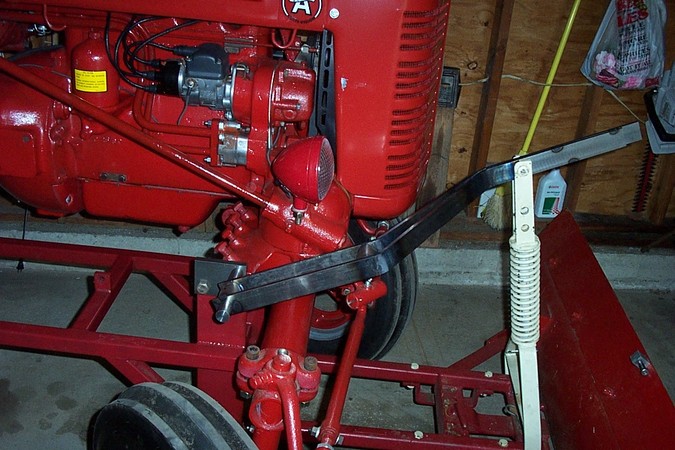

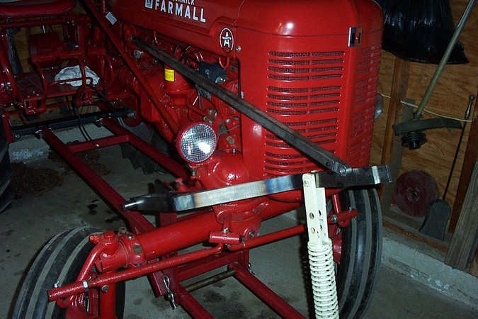

Mornin Guys,
This arrangement seems to work out well, Im getting 10" of lift at the blade and that works for me :) I added a zerk at the pivot point and other than some finish welding, glass beading and paint, Im good to go.
I will post one more finished pic when its all painted !

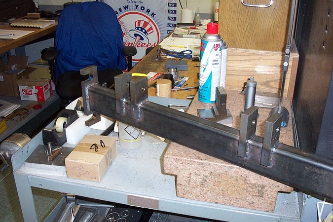

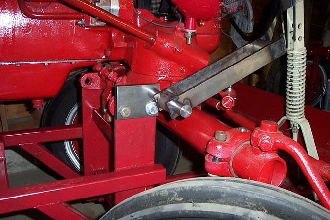

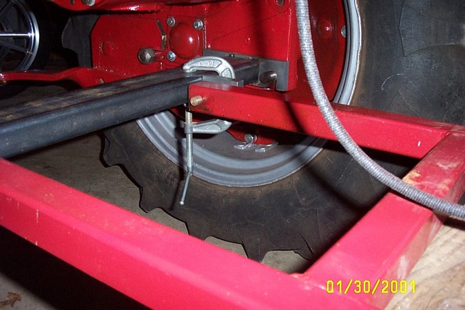

Afternoon Guys,
Sorry about the long layover ! :confused: But its almost done now.
First pic all parts are finished welded and glass beaded.
Second pic, all parts are painted and Im waiting for them to dry and will reassemble tommorrow or saturday. One final shot of everything on the tractor.
Oh yeah, one minor problem, we have no snow, we havent gotten any snow and saturday they are talking about 55 to 60 degrees ! :confused: :) The grass is green and I should be working on a mower !:)

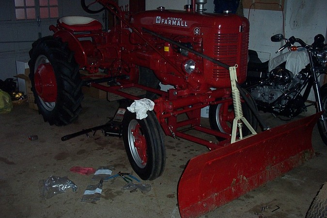

Afternoon Guys,
Seems pretty strange standing in the yard Jan 6th, 65 degees taking a picture of a snowplow :) Anyway the plow is ready for any snow we may get, might not happen till next year but we are ready :confused: :)
If by chance we do get any snow in the NE I will post an action shot :)

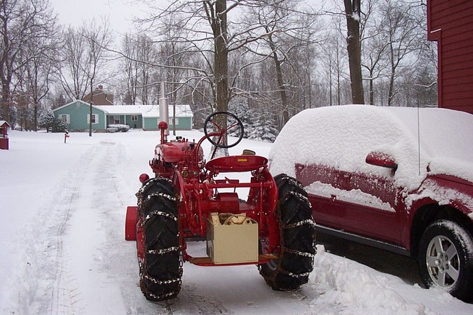

Yep, I will ! Sooner or later we will get something :) I have about 400/450 lbs on the drawbar plus 300 lbs of wheel weights and chains with ice cleats, Im thinkin it should work OK. But I will get an action shot as soon as possible :)
   / Snowplow Frame.....Super A
#30

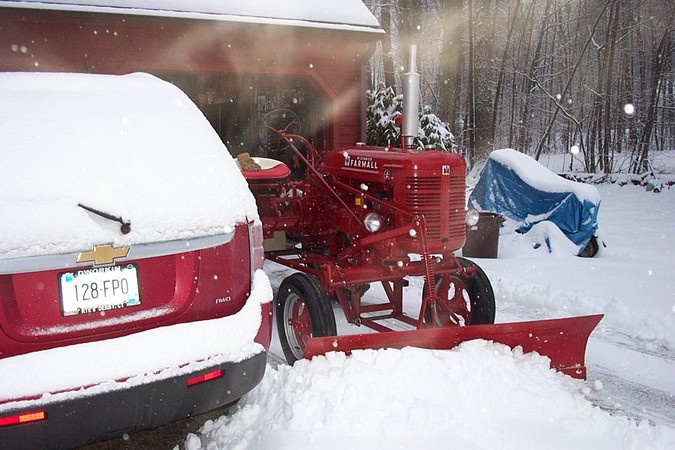

scott_vt said:
Mornin Mike,
Im thinking this may be the only action shot in Ct this winter :( All the snow is up at my Vt home so this will have to do. The plow works great ! This was plowing 3 inches of sleet.

Good Afternoon Guys,
We had about 5" of actual snow at my Ct home on monday, and even though I posted an action shot of plowing the sleet storm from valentines day I thought I would finish the thread with a couple shots of plowing real snow ! ;) The plow worked just great and wasnt straining the trip spring like when I was plowing that heavy 3" of sleet ! :)
I did do a neighborly thing and plowed out my next door neighbor, and unfortunately when I was finishing his drive I hit a patch in his driveway and sheared the 1/2" bolt on the underside of the plow for the trip spring :( It since has been fixed :)
