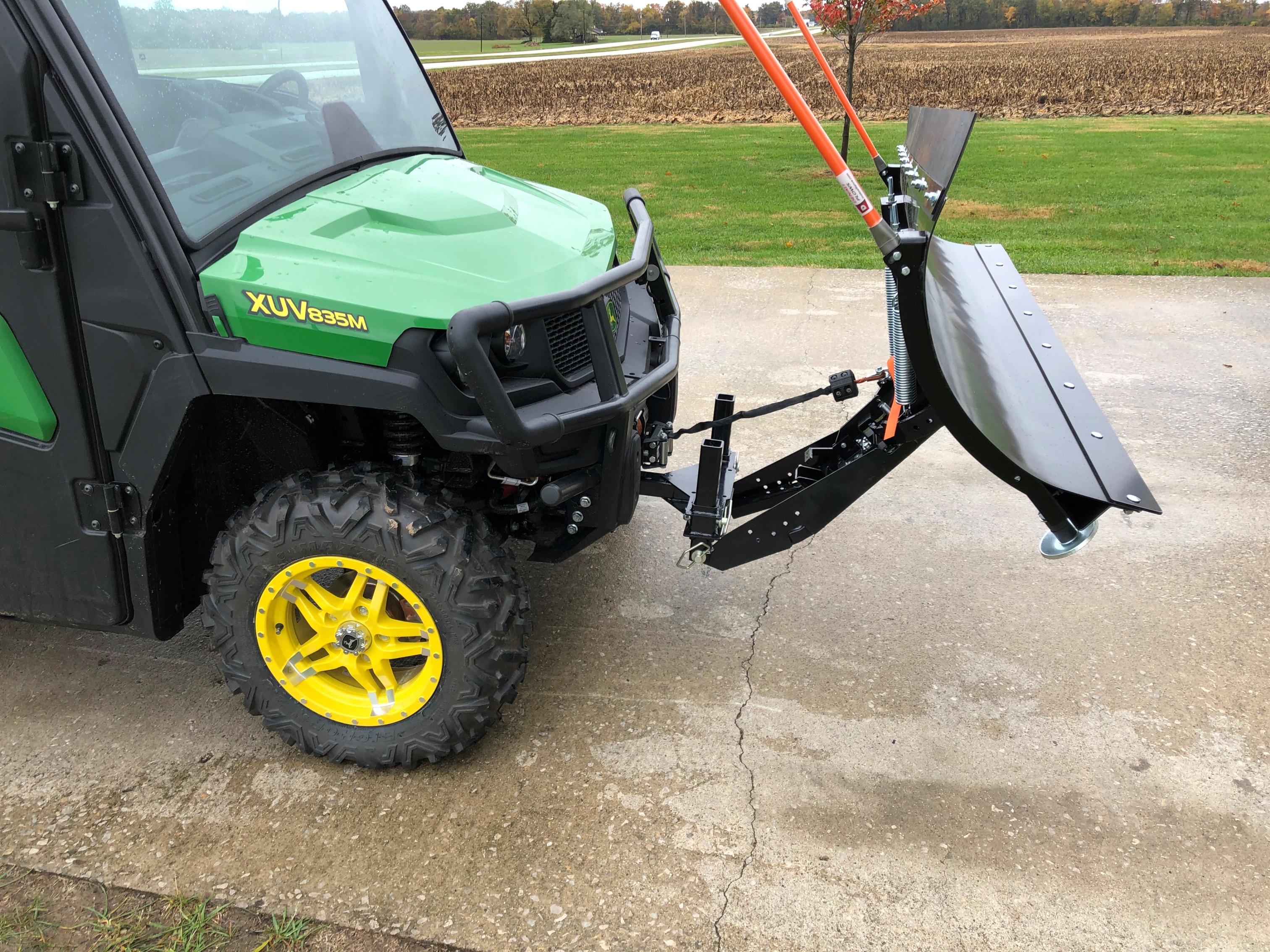

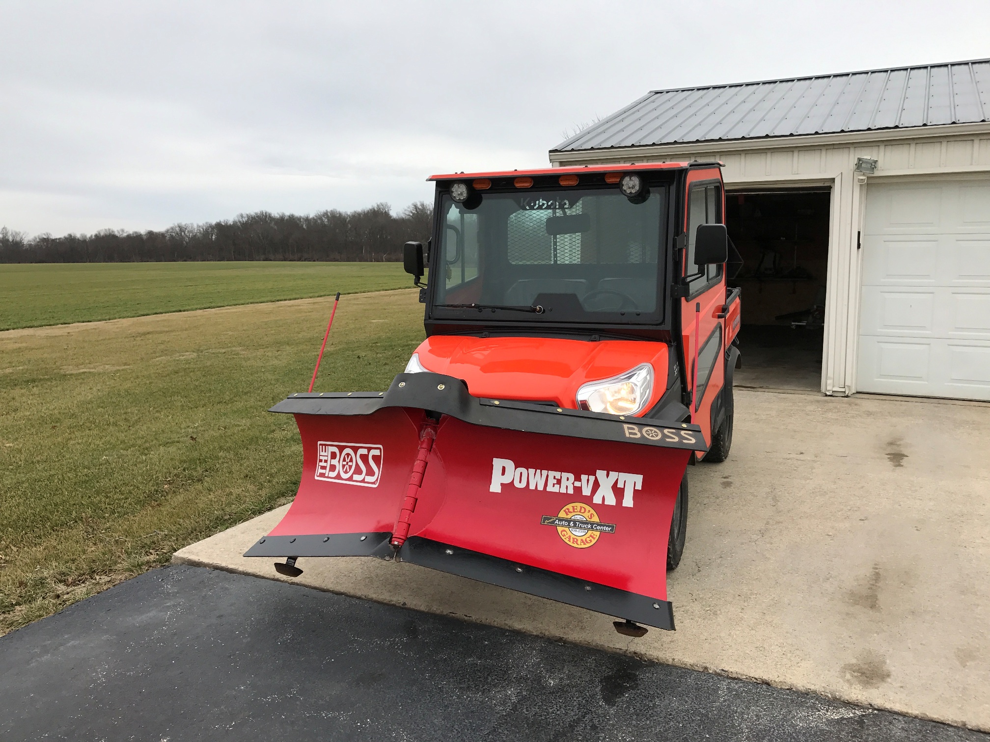

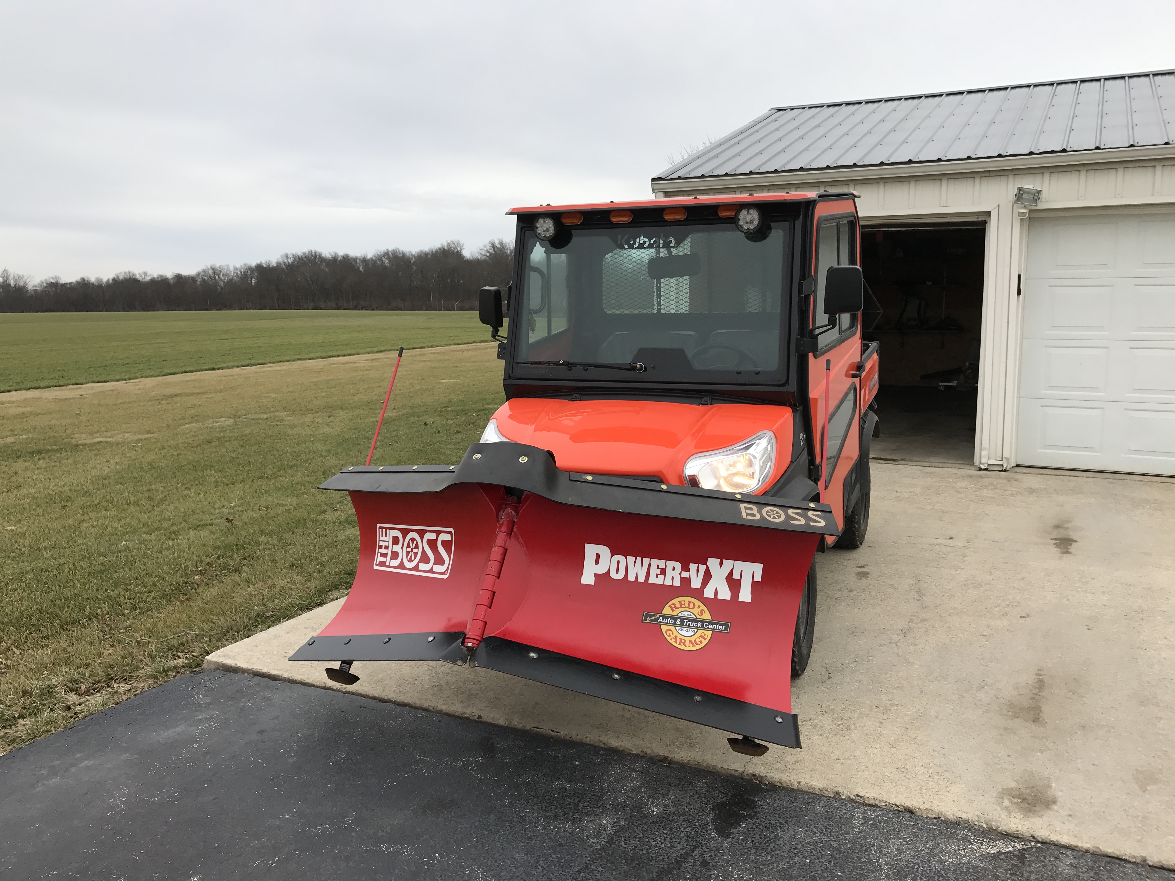

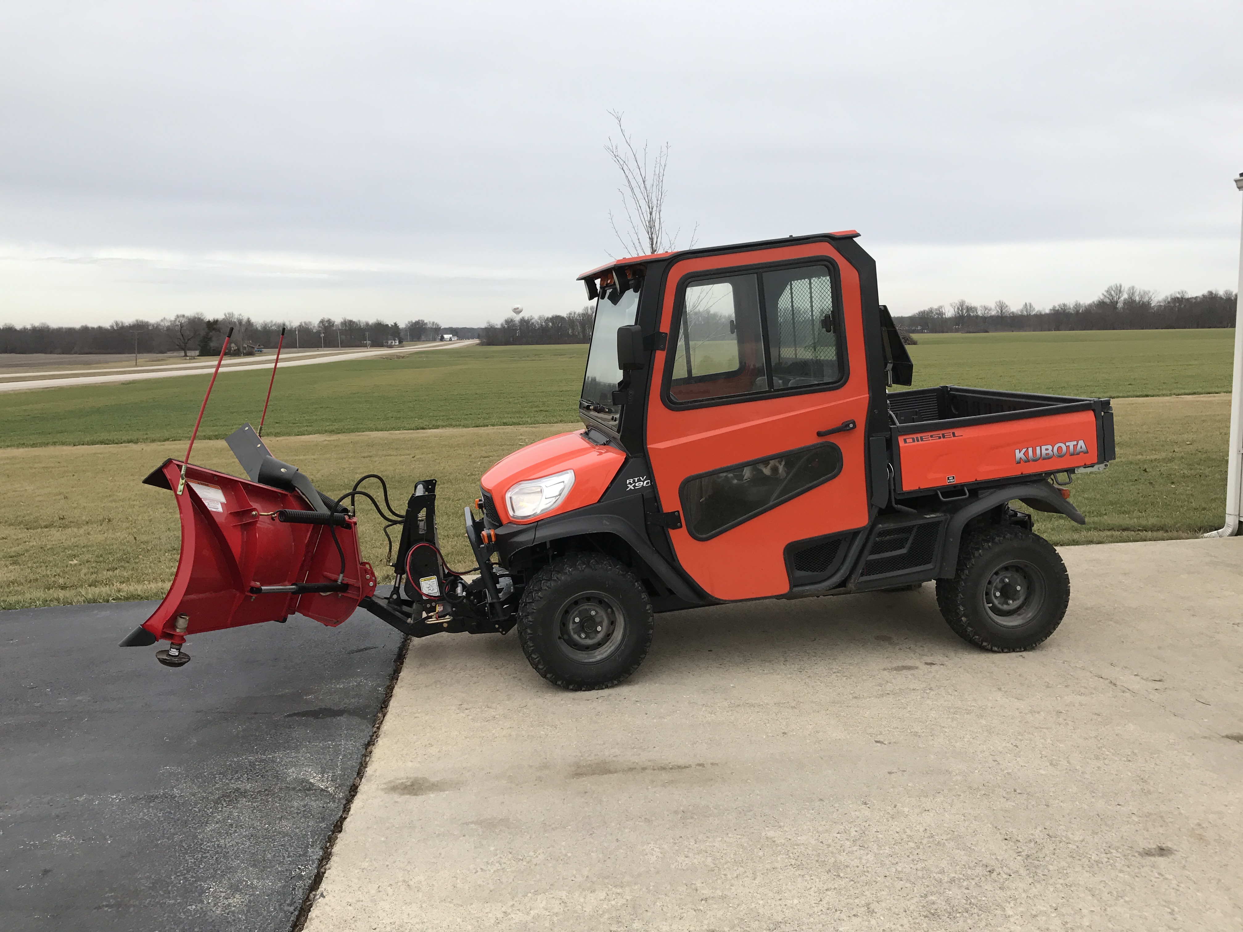

I had a X900 with a boss vplow on it. Self contained hydraulics, but pretty heavy. If you don't have the heavy duty struts and shocks you should buy them. Might need that for any blade setup. The boss vplow was a nice setup but for me a little overkill.

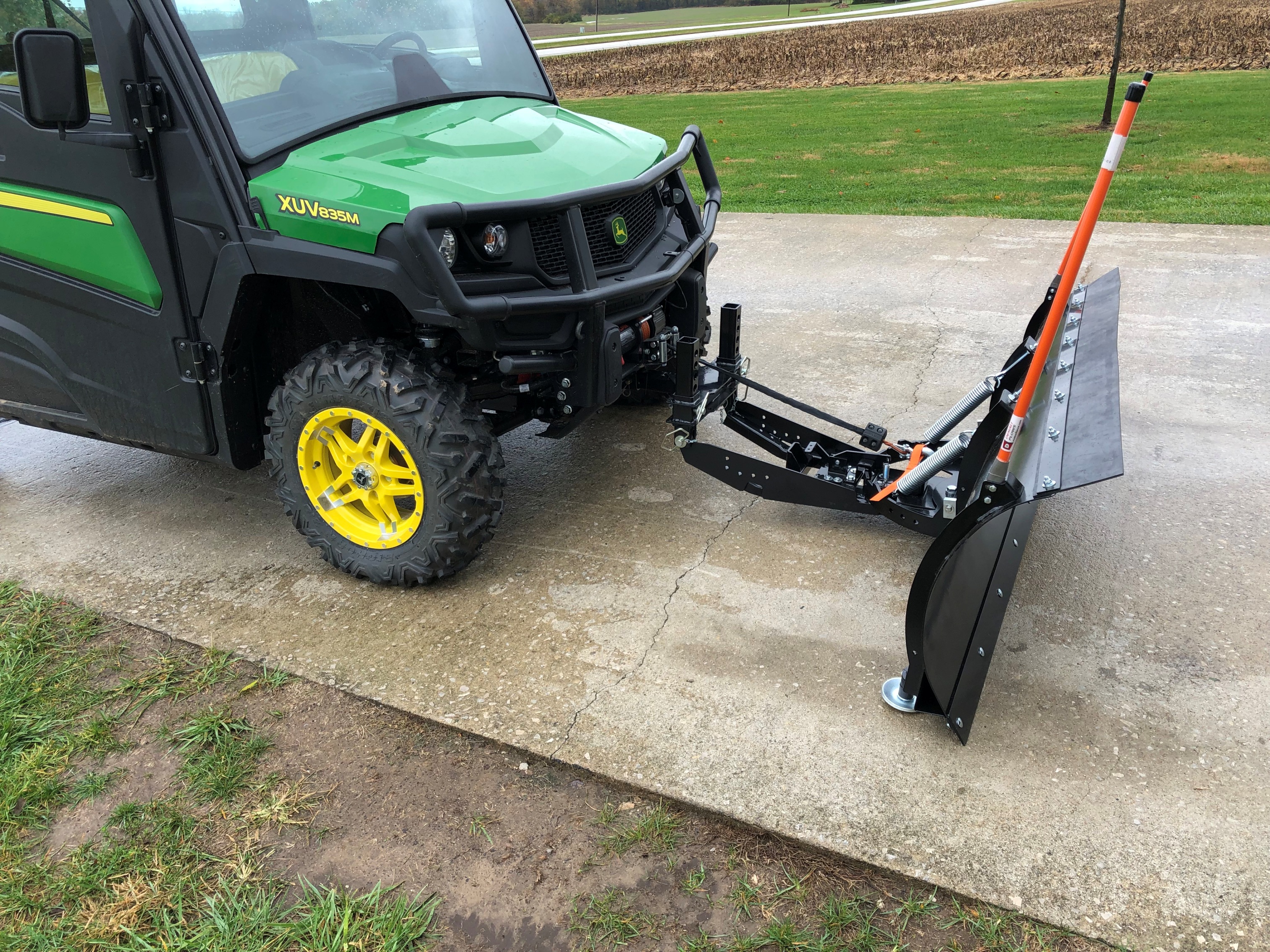

Purchased the 835M Gator this year, went for luxury. The blade on the gator now has an actuator on it to turn blade left or right. Trying to scare the snow away.

   / Snowplow for Kubota RTV900
Looks like your scare tactics are working.:laughing:
The V plows and the electric/hydraulic set up cost more than I'm willing to invest. Before spending that much I would rather go with a frame mount on my tractor.
It doesn't snow too often here, but we did get about 14 in. last week. Some years I don't do any snow removal at all.
Is the plow on your Deere a Denali Pro?
Have you used it yet?
Impressions?

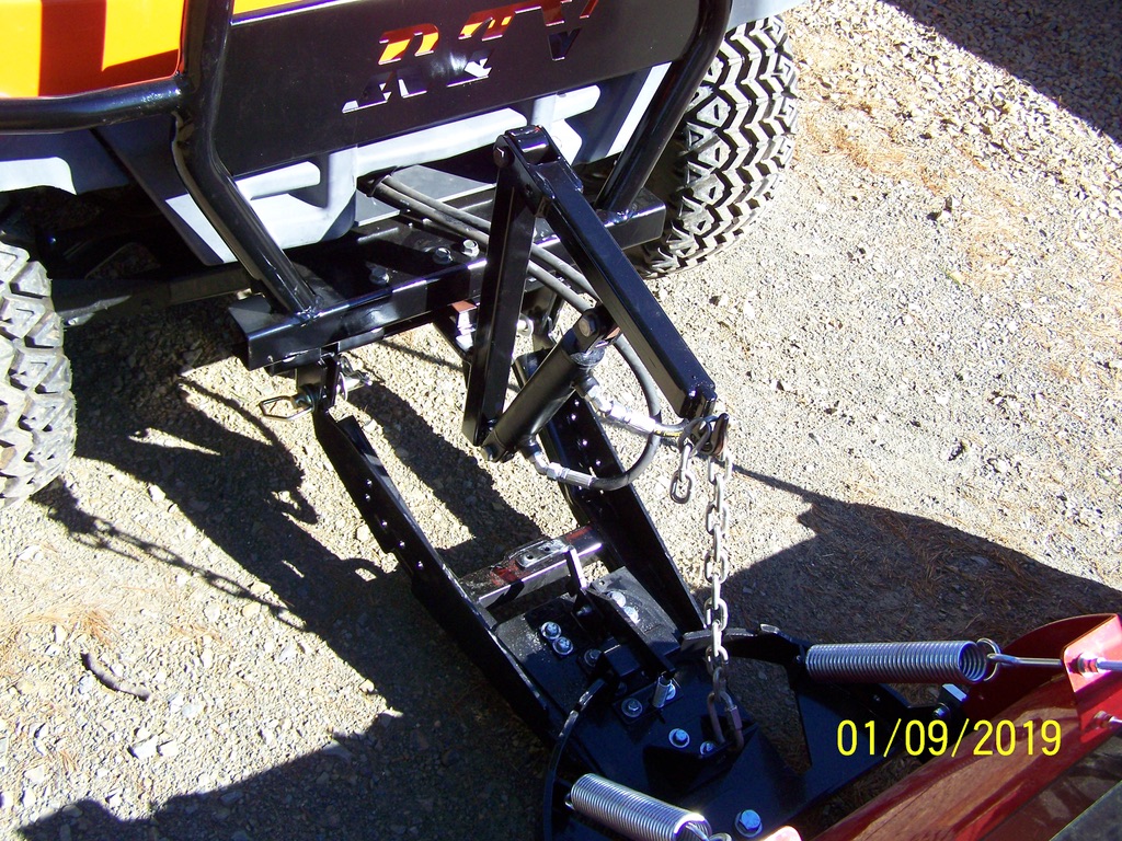

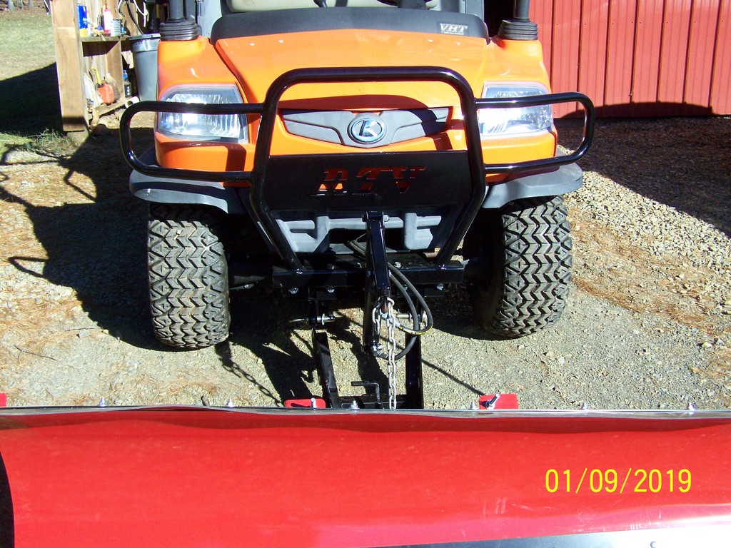

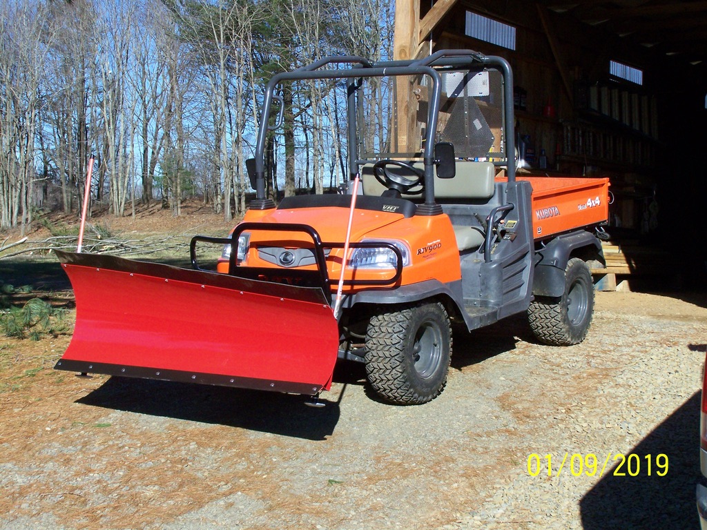

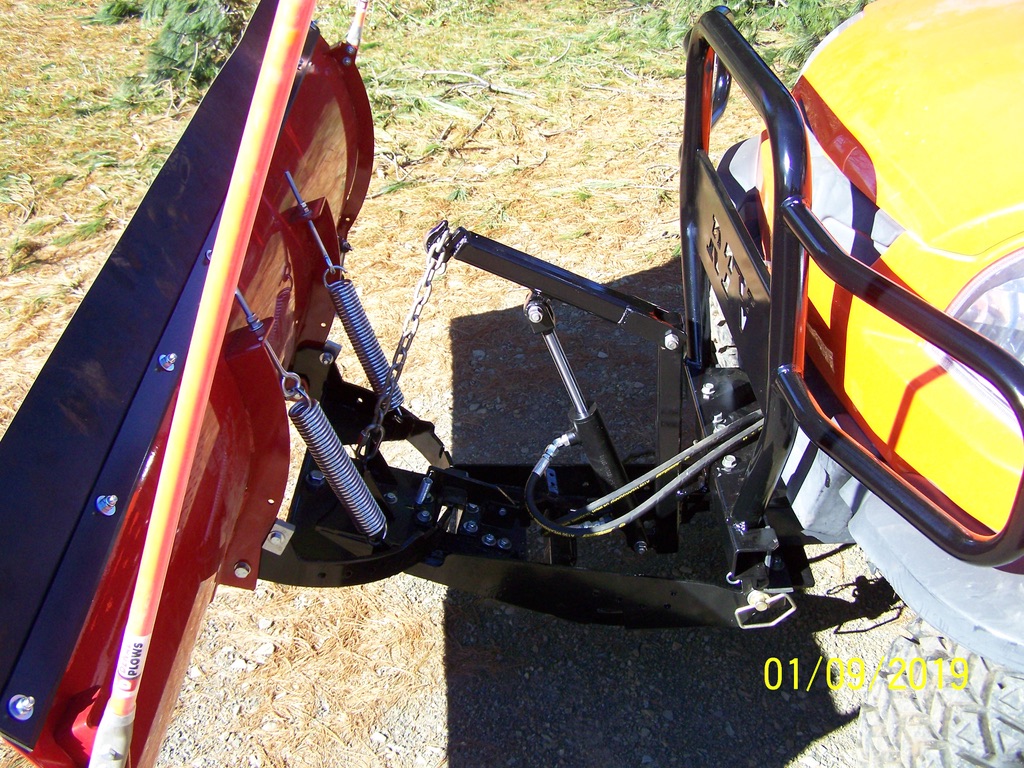

#9
I thought I'd send photos of my completed plow setup.
I bought the plow itself, which was designed to be lifted by a winch.
I set it up for hydraulic lift.
The lift piston, which is powered by the aux. hydraulics, attaches to the front 1 1/2 inch receiver hitch.
The lift works great.
Total cost for the lift system was about $190 plus $679 for the plow itself.
