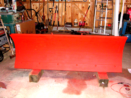

Here you go... The plow trimmed down to 6 feet
End supports welded back in and a first coat of paint.

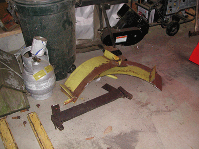

Here are the ends that I trimmed off...
You can see where I ground off the end supports...

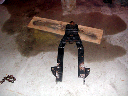

This is the A-frame trimmed down and you can
see how I've narrowed it up
I will straighten it, clamp it and weld it.
I still have to cut the tab out of one side.
This frame will put the plow about 3 inches closer
to the machine than the cutting edge of the bucket.
Regards,
Chris
