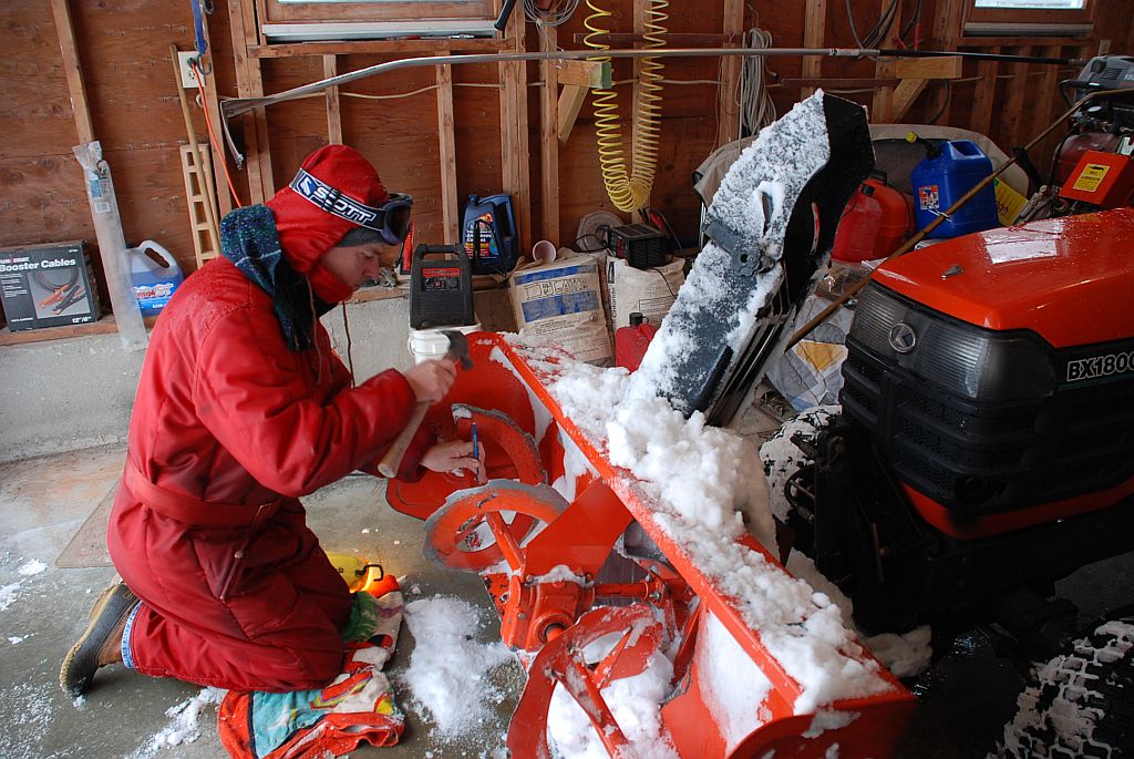

I have a front-mount 2750C snowblower attached to my BX2350. "Found" a 2x4 that got left in a bad place and snapped both shear bolts for the first time on the main auger shaft. I replaced both bolts, but I noticed that where previously there was an equal small gap at each far side of the shaft - basically it was perfectly centered, now the auger shaft is shifted to butt up against the left side and there's about a 1/2" gap on the right with the underlying shaft exposed. With the shear bolts in where they belong, its all locked in, so it can't be nudged back over. I can't even get my head around how this happened without some kind of horrible damage to the gearbox in between. What happened? Think I can leave this alone? Incidentally, I finished the driveway before I noticed this problem and it seemed to work fine. Thanks.

I was wondering if you ever got a response to your question on this? I have the same blower on the front of my BX 1800 (at least it's a 2750, not sure of the C) and I had what I thought looked like a perfectly spaced auger shaft set up between the ends of the housing of the blower. Well, I hit the 10 pound rock one day and broke both pins. The first problem I had was finding the sheared bolt, because I now too had, what you described above, about 1/2 movement now on both shafts. I ended up spraying degreaser, shining lights, finally getting one side lined up and using a punch to get the sheared bolt out. The other side would not line up absent divine intervention and I thought I'd ruined the entire unit. The Kubota repair guy came to the house and, unfortunately, I think it was his first day on the job, or any other, because he had as much luck as I had. Another repairman came the next day, walked up took a look at it all, took out a rubber mallet and hit the center gear housing so hard in one direction that I thought I was going to have to knock him down and shoot him. It turns out there is quite a bit of play in those things and it did no harm to the unit, allowed me to see how to replace the pins in the future, and only cost me about $150.00 bucks in repair visits (they didn't charge me for the first guy, since he could not make the repair.)
Kind of a long answer to what you've probably already long ago found out, but I am wondering if you've come up with any inventive solutions to lining up the holes to release the sheared pins now? I have had some success with painting some marking lines, but it really should not be so hard and my walk behind blower is a 3 minute change out when I shear a pin....something I would have hoped for with the 2750. I also notice that the difficulty in finding, removing the old shear, and replacing with a new on is directly proportional to how low the temperature is and how hard the wind is blowing on your bare hands...wondering if you've found the same thing. One more thing I figured out pretty quickly....the impeller shear pin is difficult to get a wrench on and the replacement bolts come with self locking nuts, but they are just about an inch and a half longer than they need to be. I figured out very quickly (probably should not have to, but kept breaking shear pins until I got the mental map of all my property down pat) to buy a bunch of the bolts and cut about a 1/2 inch off the end of each bolt to at least make that operation go a little faster. Just wondering if you've had that same experience. Dyer, retired

robbo323,
Does this operation look familiar? Dyer, retired

You knocked the end support bearings loose. recenter in the housing and tighten the bearing locks.

The shear pin, shaft alignment problem was solved for me by "kevinj" on TBN yesterday. I attached my response to him from this morning, so I think I'm all set now. I am enjoying and learning an awful lot from this forum!
kevinj,
You were right on the money. I went out this morning and put an allen wrench on the bearing set screws (2 on each side of the auger shaft) and not one of them was even remotely tight. I decided to take the bearing support (flange bearings the parts book calls them) off and take a look while I was right there. I'm assuming those bearings are sealed, but the left side, even with the set screws completely removed did not move on the shaft until I put some light pressure with some expandable pliers. They sure move now, are all greased, adjusted, locktite set, reinstalled and working like a charm. Everything now lines up as new and does not show any spacing between the auger shaft and side housings, so I'm pretty happy....until I hit the next thing and move the bearing on the inner shaft again. I then took the sheer bolt out, with some difficulty and thought...here we go, but it turns out that the bolt had already begun to shear from previous work. The holes line up perfectly and I slid a new shear bolt in through like it was covered in butter. In other words, I'm pretty happy and thanks for solution. I know it's not the biggest job in the world, but it sure is satisfying to do work that Hammond Tractor would charge a minimum of god only knows! Thanks again. Dyer, retired
