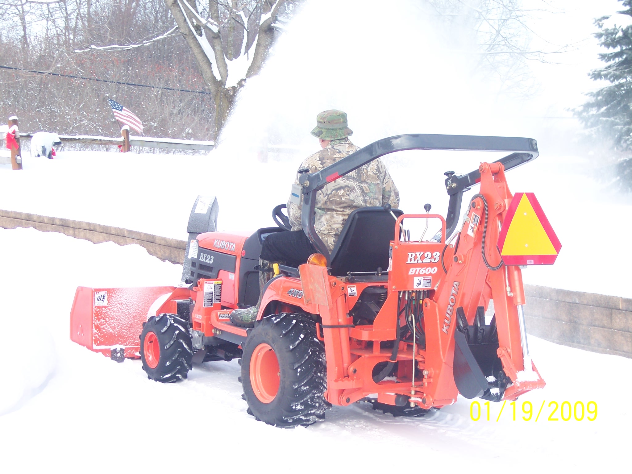

DevilDog
   / Snowblower use question #8
When you remove the large rocks from driveway you snow blower will work just like this. A breeze to blow when there are no rocks or items to break blower.:thumbsup:
