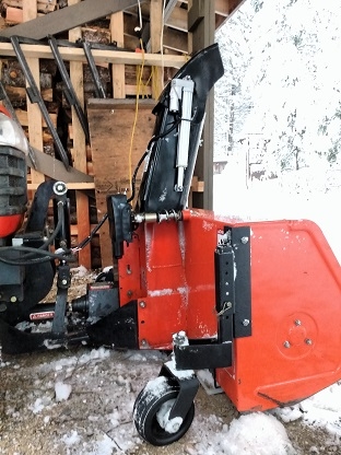

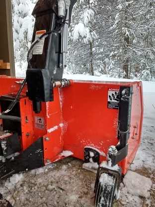

I've thought about using something like those skids, but don't they cut gooves in the dirt?
No one seems to use tires instead of skids, but it seems to me they would work well - maybe better.
What am I missing??
rScotty
Someone does.

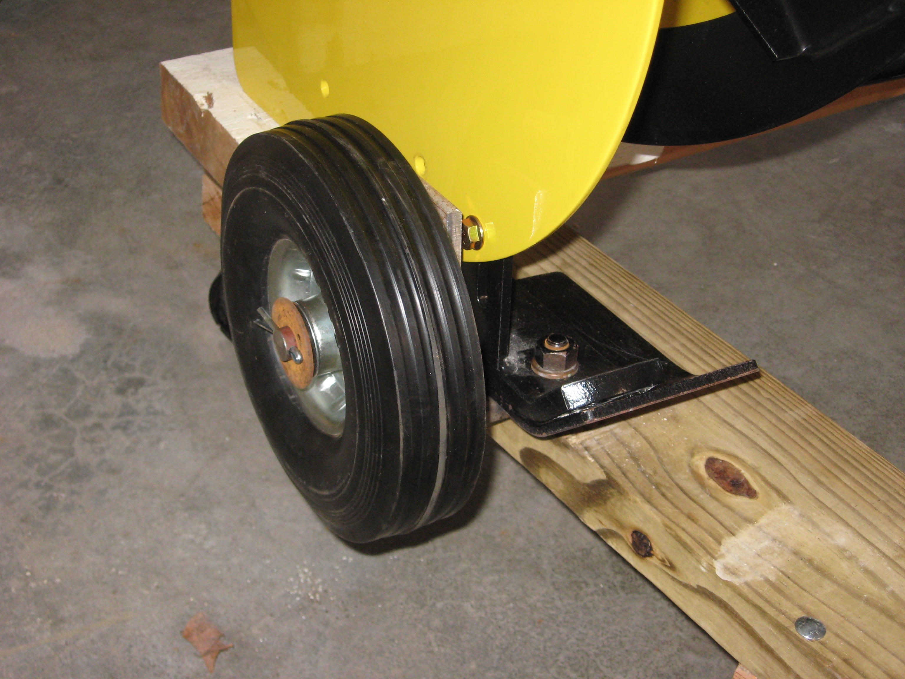

I found this site that makes wheel setups for plows and snowblowers. I think they would work fine for folks that have blacktop or concrete driveways. Problem with wheels, they don't have enough surface area to support a heavy snowblower on softer ground. I think the skids are the way to go for dirt driveways. The aftermarket skids that I see out there IMHO still need to be wider and longer.
