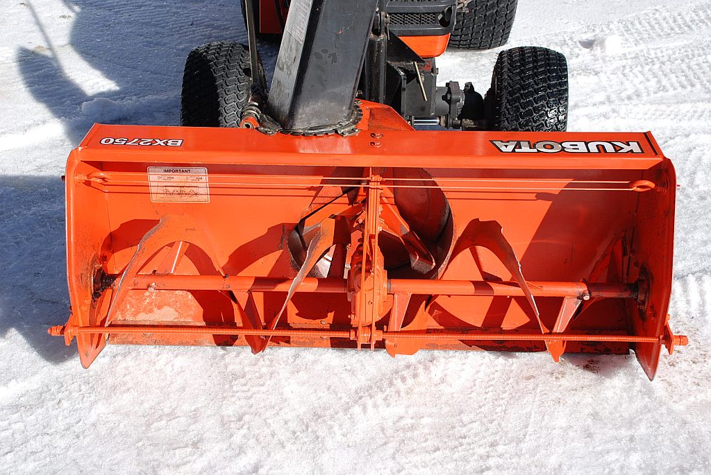

I broke a LH shear pin on the blower (my left hand), and like others I have noticed a gap on the side of the auger and the bearing flange. The only way I could find the broken pin, was to remove the 3 bolts that hold the bearing flange on the left hand side and move the bearing flange to the right. If I leave the bearing flange to the right, there is a gap between bearing flange and sidewall of the blower. Its all put back together, the gap between the bearing flange and auger is there, and if I break another pin, the auger will go left and the fun starts all over.
So one of my questions is where is mis-alignment coming from? Was the blower not set-up correctly?
Something appears to be shifted to the right (my right) Hence the gap on the left. Do I make a spacer to fill the void between the bearing flange and sidewall of the blower to avoid the 45 min shear pin replacement time? Its either a bad setup or a bad engineering.
Does any one know whom makes these for Kubota?

Sounds as if the drive mechanism is shifted to the right. Maybe if you loosen all bolts holding it you will be able to move it to a better position and the tighten.

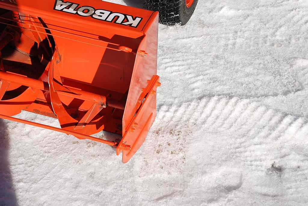

Mike,
I have a BX2750 blower (I couldn't find what your blower is, but suspect it's the 2750) and had the same thing happen for the last 5 years. The reason I'm assuming it's the 2750 is because the sheet metal is fairly thin and I found that my wings had bent slightly outward...causing the space you describe. The bearing collars have a set screw, but it's not meant to keep the bearing from being pulled sideways. I used some woodworking clamps to pull my wings back to where they should be and retightened the bearing collars, but the same thing happened all over again the next solid snow bank I ran into....and the pins were a bear to find when they broke. I measure the inner wing to inner wing and had 51", so 1" more than I should have had. Also, once the pin shears, it blends nicely with the shaft in all the grease that's in there, so it made it more problematic to find and replace. For a few years, I used a rubber mallet to strike the center gear housing (that's how the Kubota service repair guy did it one time when I was not having any luck changing the sheared pin out) to get the shaft to go in the direction I needed to find the hole again. I also tend to think that with the wing auger shaft and drive shaft pulling sideways against each other, might be causing the shear pin to fail all that much faster. I got sick of it, as it sounds like you are, and devised a fix. It's pretty primitive, but I haven't sheared a pin since I rigged it. The wings are exactly the same distance from the center gear housing and now measure exactly 50" from wing to wing. You can see what I did in the pictures, which essentially just holds the wings at the correct width. Disregard the top wire part of the fix, I was playing around with an alternative wire fix. I call it my $50.00 solution to my $1.00 problem, but it sure saves headaches. I can loosen the shear pin, pull it out and replace it by rotating the auger and lining up the holes.....as it was meant to do. If I break a pin, I rotate the auger and the sheared piece falls out on it's own now. I don't think the heavier gauge blowers like the 2781 and up have this problem? Dyer, retired

I should have said that I have the BX2750 blower on my BX2200. I never would have thought about the sheet metal bending. However, looks like the tape measure needs to come out and see what's what. Base on your photo's, you have wire at the top, and it appears another bar at the bottom. You must have found that you needed both, yes? Your remedy is definitely food for thought.
You are right about being tired of searching for broken shear pin. Last year was a two adventure, and the one I broke on Saturday was another 2 hours of laying of head scratching. I even came here to see if I could find a quicker fix.

The wire at the top of the photo was a backup and really just experimentation more than anything. The bar at the bottom is just a 1/2" threaded bar. I've run two more steel square stock pieces down from the center support exactly in the middle of the unit and that allowed me to draw each side in kind of independently to the right measurement.
In the meantime, the rubber mallet works fine. I've been able to change shear pins out in 5 minutes before, but it was usually taking 20 minutes. I'd have to spray the shear pin hole with engine degreaser, so that I could see the outline of the sheared piece in the drive shaft, pound the mallet to get the holes to line up exactly (that pin won't come out otherwise...even if off a little) and then I'd use a nail set to tap the pin out. And of course, it's never convenient when the pins shear and I could never change the things with gloves on, so it would be a nice hand numbingly cold experience to add to the fun.
The wings don't flex out much, but as you are finding out, it doesn't take much to cause you a headache changing those things out. Dyer, retired

I should clarify that the wings bending out didn't cause the pins to shear, but I suspect that the added side pulling stress didn't help much. I was shearing pins the old fashioned way, hitting ice chunks, hidden tree branches, good old rocks, etc. I think the bigger rocks may have caused enough of a jump to the auger shaft that it pushed the wings a little just before the bolt sheared. The problem was that when the wings shifted and a pin sheared, it was very difficult to line up the auger shaft with the inner drive shaft hole, which is what SailTrac is experiencing. I was shearing enough pins in my first year with the blower from hitting everything imaginable, that I made sure to keep a big supply of shear bolts on hand. ;) Dyer, retired
