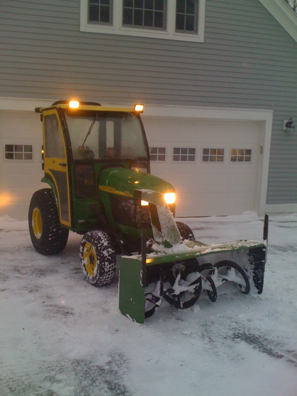

The only way to go. Have never met a person that has tried both and prefers the rear mount. I have loaded turfs and have never had a problem.
/ Snowblower Rear or Front Mount
#11
Yes Turfs front and rear, rear filled,
Got front and rear chains on order,
Yes 380A Front Blade, which does work great going down hill,
I thought of trying to blade it back to the middle, will give it a go next time,
I know all too well where the sides of driveway is!
Once you feel that little rearward slip, it's too late,
Got strap pulls on order to replace cable come-a-longs, but definitely use caution,
Feels okay at first turning around, does limber you up a bit,
But does wear you down in the long run,
Turning the wheel the opposite of what you feel like turning takes some thought,
Steep drive with hair pin turn, view down to the road below,
