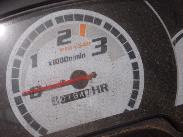

My B3030 has an idiot mark on the tach for 540. I don't see where you would get a choice.
The B2150 has a mark for 540 as well at 2500 RPM's, but no mark for 780. I "Assume" the gearing is such that the same engine rpm gives the PTO 780 RPMs when the PTO speed selection lever is set in the 780 position.
