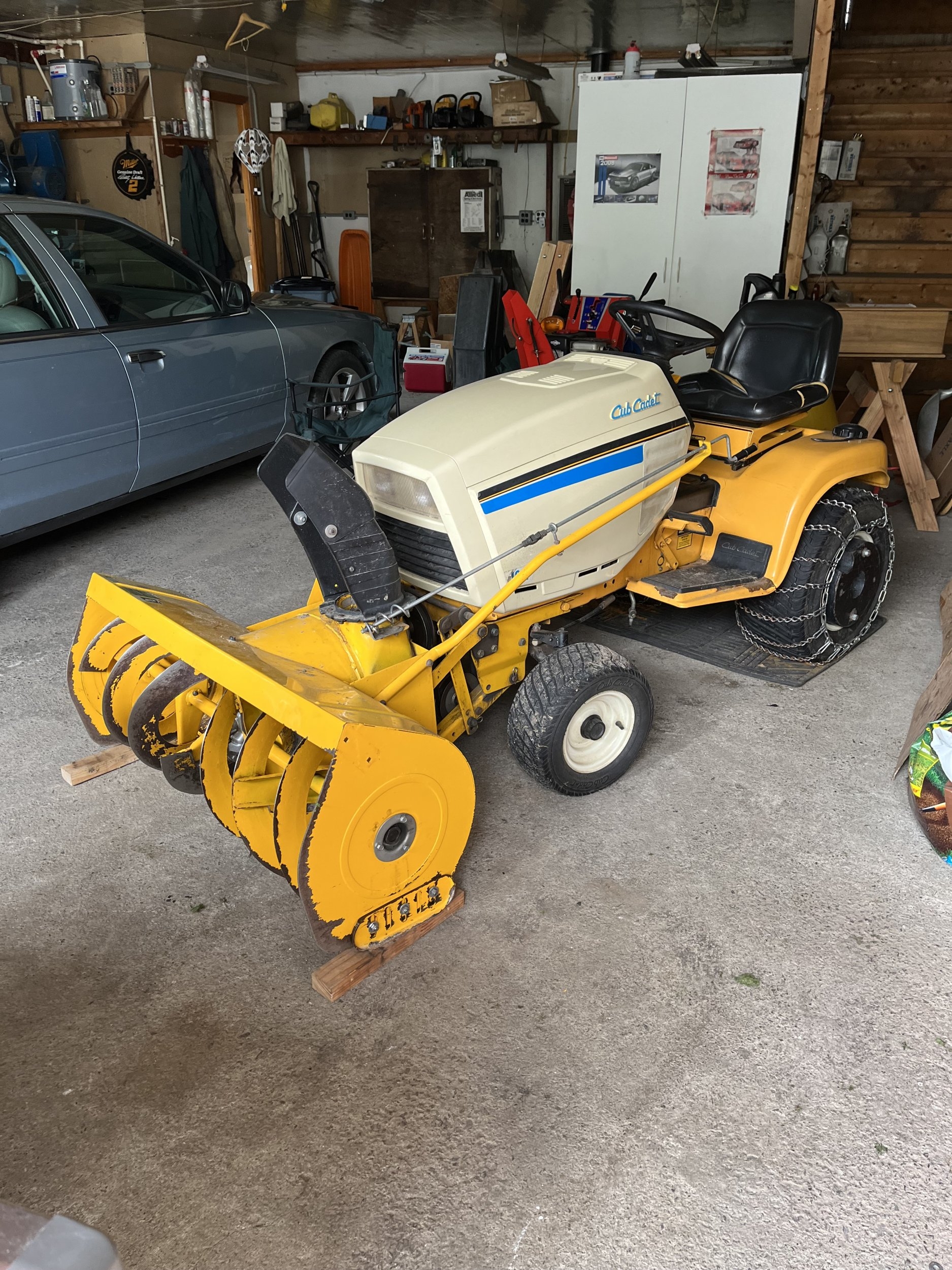

My 1995 cub cadet 1641 16 hp Briggs & Stratton, with a 45 inch blower. Throws the snow farther than my brand new x739 John Deere with a 25 hp Kawasaki 54 inch blower. And I am using them in the same type of snow for some reason John Deere just does not throw as far as some of the other blowers. It does throw it far enough however so I don’t have any problems but for the money I paid, I would expect it to throw just a little farther than 20 to 25 feet.
