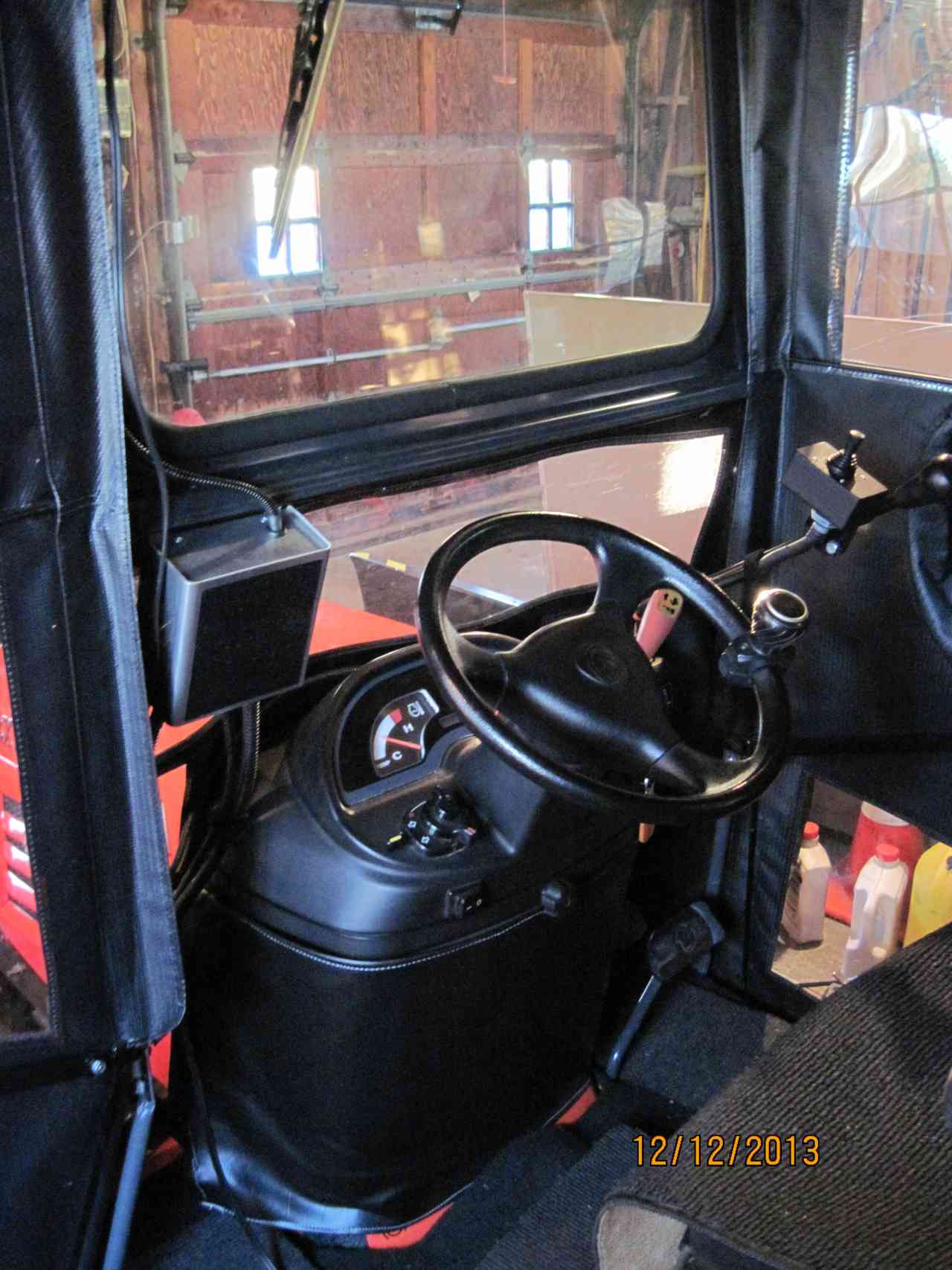

I'm going to be electrifying my blower with it. Linear actuator is $50 or so for tilt. 5@ draw tops, need to look at the stick when I get it to see if the switches will be happy with that.
Have yet to figure out what to do for rotate. OEM solution is wrapping some cable around the drive shaft on the rotate handle & using it like a 2 way winch. Have a cheap ATV winch I may use, but it's WAY overkill power wise.
   / Snowblower Joystick giveaway #12
Here's the result. The SS box on the left contains the relays and connections.
Looks great. I may have to look into it in the future. Pretty sure I would need some help with the wiring. Thanks for the pics
