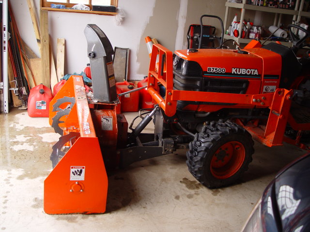

5030's right re: consuming power. I have a front mount blower on my Kubota B7500 - 5' wide. You do need to crawl along slowly when you get the heavier snow that's 3-4".
Powder is much easier, but it usually all ends up in my face.
