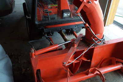

I have a hydraulic chute rotator on my snowblower and it works great - just a simple swing arm with a cable wrapped around the chute. I also have a hydraulic cylinder on the deflector. All it takes is a simple hydraulic circuit from a spooling valve.
