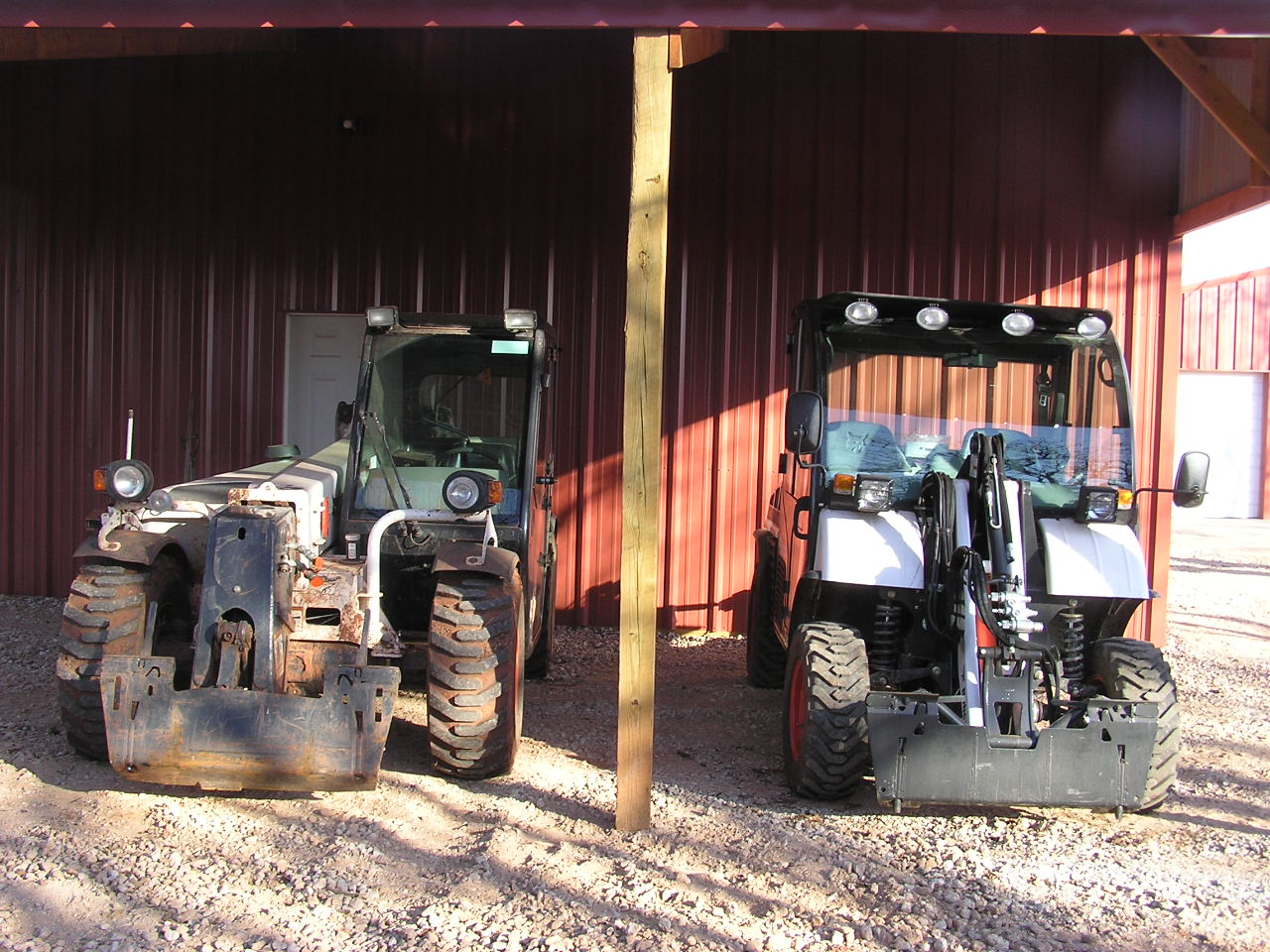

Yep, the same and for most skid steers and compact telehandlers.
