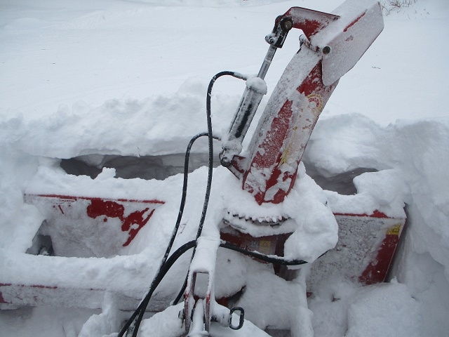

1) Looked at them, M7060 12 speed cab is less money for smaller cab.Either will work perfectly fine for snow removal with loader or blower. Currently run an M7040SU which is same power size. Planning to get a cab model in future. Will do same work.
2) Shuttle will give you same speed back and forth for plowing with loader. High range 1st, clutchless shuttle etc. Drive with foot throttle and shuttle lever.
3) Control speed with foot throttle, you left off pedal and you slow down instantly, clutch/shuttle to N to stop. I keep left foot clutch ready if I am into something I need to stop real quick. No issues stopping fast. HST isn't an option for me in HP class.
4) Not really, might be nice snow blowing, I don't have it and run a 78" blower in 1st reverse easy. Do have to clutch a bit but I do 99% of my snow in multiple driveways and farm yard with blower.
NS/NB dealers do have "territory" so best to buy where your home address is near.
