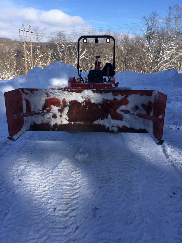

I stopped plowing on Friday night at 10PM and was too lazy to get out at 2AM - hence 3 hours from 6-9 to clean in the morning. It was possibly the hardest work for the 20hp Kubota. I have 5 feet 3pt blade and turf tires. I ended up pushing backwards to be off the deep snow with my tires and making a zigzag path to deposit snow piles along the way.

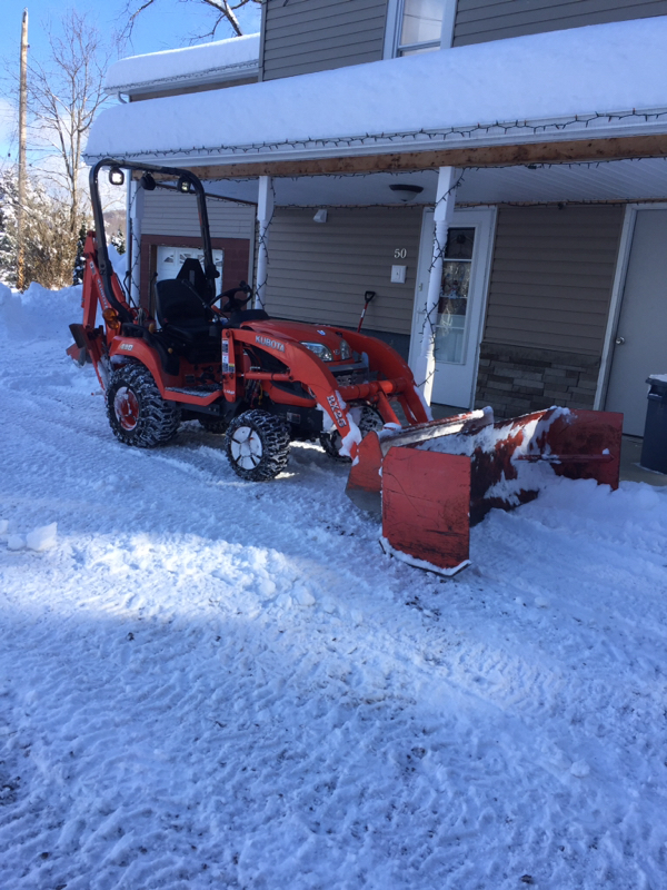

4 wheeler plow fast, probably 5x-10x faster than my snowblowers, plus youre going forward. That all changes if you get to any significant drifts. At about 20" the ATV loses out in drifts and becomes a PITA. Its quicker to get the walk behind blower than sit there ramming packed snow. I dont have a blade on the bx, but I do plow with the bucket. You can plow pretty fast, but there is a lot of spillage so you have to go back over. You can only pile so high too. BX snowblower works to get the snow away, and if you have any accumulation, a blower is required. Blower is probably faster than the bucket because its single pass to clean 50" as opposed to multiple passes with the bucket. Next year Im building a snow box for the front of the BX, if I get a QA geared up. That will help the spillage problem
I built mine couple years back an love it.
