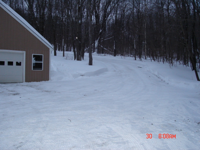

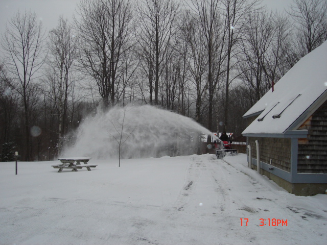

   / Snow removal with a BX 25 #21

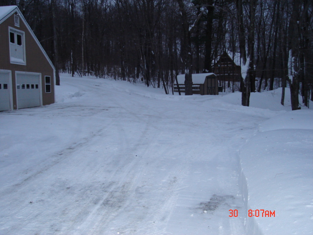

Notice the lack of high snowbanks on the sides of the driveway.... 'nuf said.

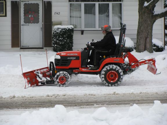

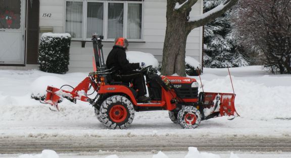

I use the front 60" hyd angle blade and a rear 60" blade with hyd angle. This works very good for what I have to do. I do about 15 driveways around here the back blade gets close to the garage doors then I use the front blade to clean the rest. We get a fair amount of snow around here and the BX has never had a problem pushing the frozen piles back to make room for new snow. If I had a single bigger area to do I would consider a blower. I do have the skid shoes on both blades I think it helps with the wear on the cutting edges and the driveways. Here are some pictures of the BX in the snow.

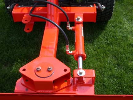

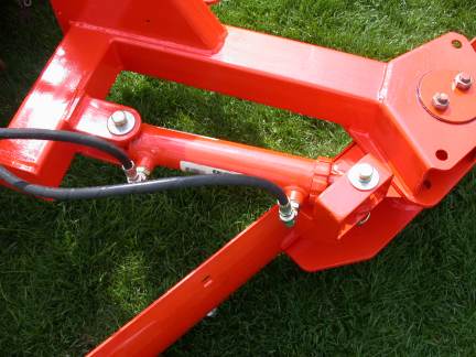

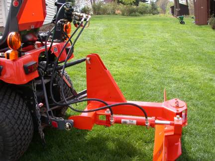

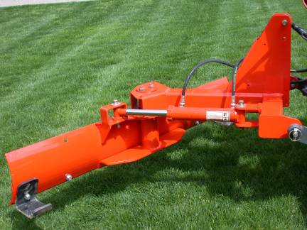

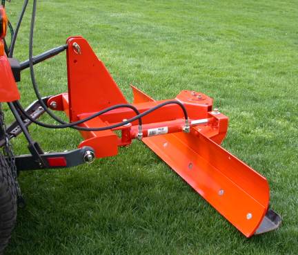

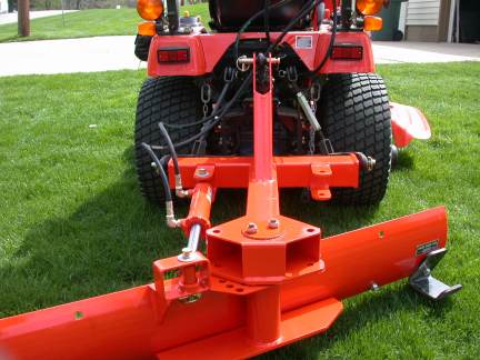

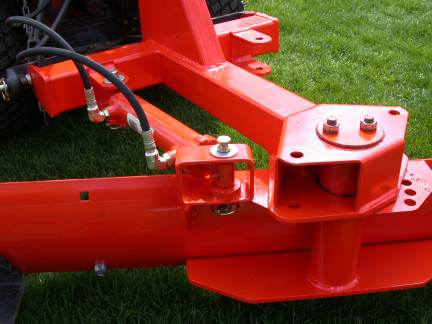

Hi Jeff & jas67, yes I did fab the brackets for the rear blade. I used a 2" dia. x 8" stroke cyl. I did a little testing to figure out the placement of the cylinder mounts so 1/2 of the stroke would move the blade from straight to the point where it angled the farthest with the pins. I also added another mount on the other side of the blade frame so I could use the cyl. with the blade reversed and the same pivot mount on the blade. And with the skid shoes and the hyd. top link I can adjust the blade to go over joints in the driveways or shorten the top link and scrape ice right down to the pavement. I included a bunch of pictures that will show it better than I can describe it. LOL
Scott

   / Snow removal with a BX 25 #28
Hello Scott
Thank you! That blade I presume is a Woods RBC60? Same as mine! Now I need to get to work copying your hydraulics setup!
Thanks
Jeff
   / Snow removal with a BX 25 #29
Scott
Nice! That's just what I want!
Jay
