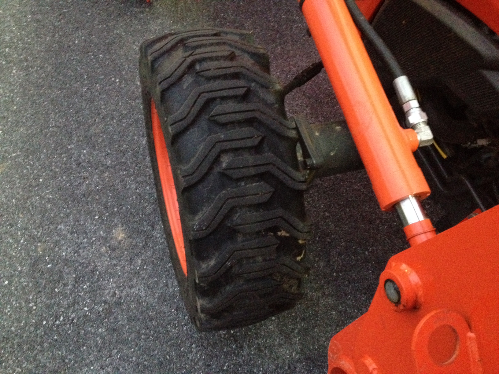

I've had good and bad experiences with R4's in winter. They worked fine on a short ~100', flat, asphalt or stone drive in Wells, ME. I left the backhoe on for weight. Here I have a sloped, stone, much longer drive with a southern exposure. After I did a tractor slow-mo 360, and could have ended up in the road, and got stuck a couple times, I decided I needed chains. Love my chains. :thumbsup:
