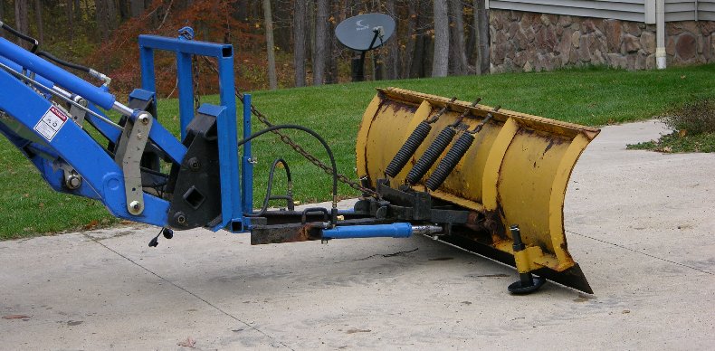

Last fall I picked up this used Myers plow for a tad over 100 bucks. I'm now in the process of making it look nicer.

I use fel,7 ft rear mounted blower and an old 8ft. truck plow I picked up for $100. I welded on a piece for the top link to hook onto and swivel the plow by hand as needed ,and drop in the pin to hold in place.The advantage of a reg. snow plow over a scraper blade on gravel drives at least is that they will trip if you hit something that won't give way.I leave the fel. on all the time and switch between the blower and plow depending on snow conditions.I use the plow whenever possible as it is the quickest for sure.
