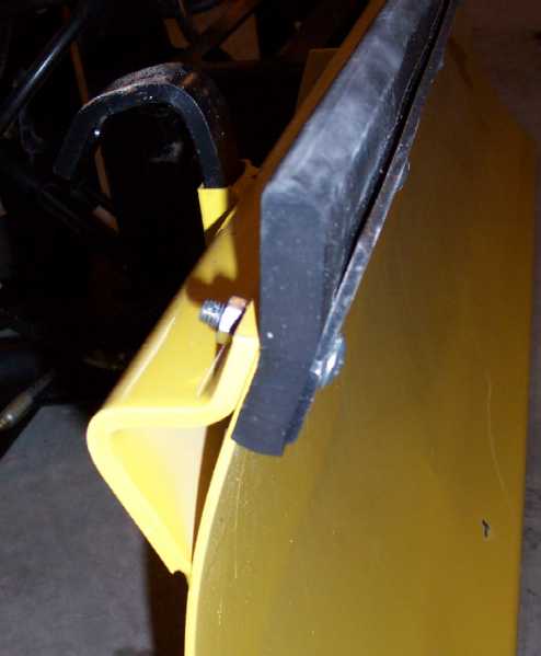

When you use your FEL or Blades on blacktop are skid pads needed? I used my FEL last time and floated it on the surface (no skid pad). It seemed to scract the blacktop a little. Any suggestions?

I do use skid pads, and eventually I want to get the "squigee" that goes on the blade.

Hi, Nuru.
Save yourself some money on the squeegee this way:
1) Head out to your nearest Tractor Supply store and buy a 4' by 6' cow mat. Cow mats are solid rubber, about 5/8" to 3/4" thick.
2)You will also need to pick up some carriage bolts and nuts that are the same size and steel grade as the stock cutting edge bolts in your blade, but probably 3/4" to 1" longer.
3) Cut a strip from the long dimension of the cow mat that is about 1" to 1-1/2" wider than the cutting edge from your front blade. Trim the length to match the cutting edge length. A utility knife works fine with a couple of steady passess--careful ! /w3tcompact/icons/eyes.gif
4) Use the cutting edge as a template to mark and drill holes in the rubber strip that will accommodate the same bolt pattern as the cutting edge and moldboard.
5) Sandwich the squeegee strip between the cutting edge and moldboard and secure with the longer bolts(see attachment). Of course, save your shorter bolts for when you remove the squeegee in the spring for use in the dirt.
I think JD charges over $65 for the 54" squeegee kit and all it is is a strip of rubber with the corresponding holes drilled, and a set of longer bolts. A cow mat will cost you about $40 and you will have a lifetime of squeegees from one mat. I use my slightly undersized cow mat remnant on the floor in front of my work bench as a fatigue mat. I set my skid shoes 1/4" higher than the squeegee blade bottom so there's nothing but rubber hitting the asphault or pavement when I plow, but the skid shoe will protect from a real deep gouge if I bottom out for some reason.
Never worry about scraping or gouging again. This is a real fast setup. I plowed seven, 250'+ asphault driveways of 5" of snow last week in about 2 hours. My neighbors love to see me out in the winter.
Works best, of course, on asphault or concrete. Rotate (flip-flop) the sqeegee a couple times each plowing season otherwise it will wear and fold in one direction.
