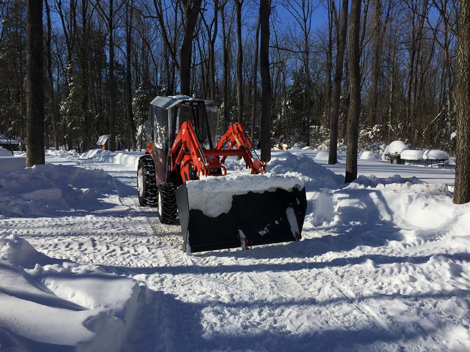

Not real long, 250' plus an area between the house and out building that measures 70'x 90'. I will check out this "edge Tamer" you speak of.
For that short of a lane, on gravel that doesn't want to stay put, I'd just put edge tamers on your bucket and be done. After you see how easy it is, you'll be itching to put a bigger bucket on the front.
As far as snow buckets go, I probably went a little smaller than I could have - but I bought mine for multiple purposes - wood, mulch, loose dirt & stone (factory bucket is so pitifully small)!
To give you an idea of how big a 1 yard bucket is, here's a picture on my 45hp DS4510HS which is one frame size up from your CK for perspective...

Now that's a bucket :) You have a bit of snow too.
