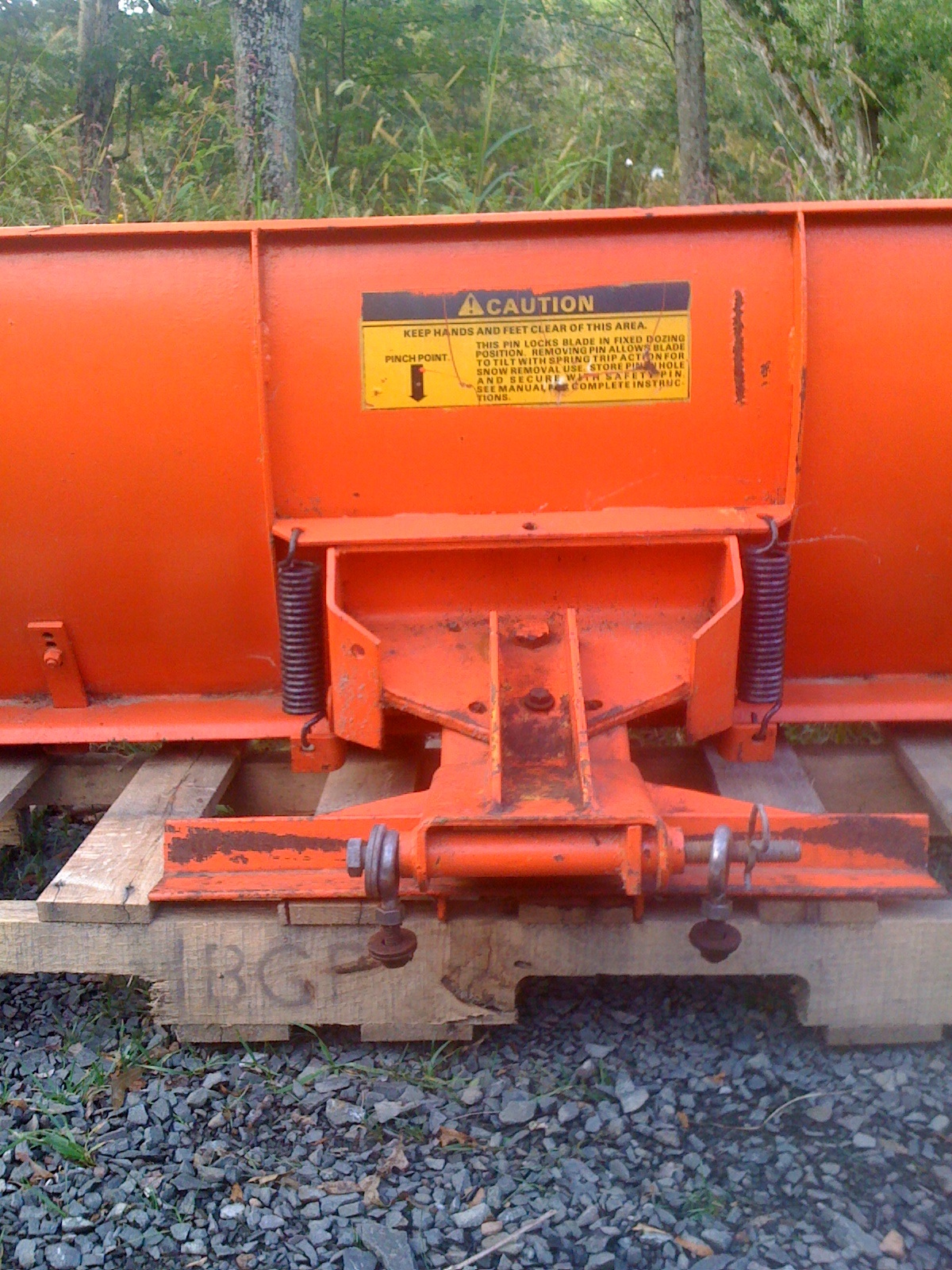

Need some advice:
I just bought the attached snow plow that bolts on to the Front End Loader. The FEL rest on the angle iron and the two eye bolts go through the bottom of the FEL. That is all I learned when looking at a Kabota 7100. I have a JD 650- 4 wheel drive. where the bucket is 48" wide and this plow is 6 feet. Both the bucket and plow are made from 9 gage steel- .140"
I noticed some members have a BX expander plow. One picture had the top of the plow bracket chained to the top the bucket, I will try to do the same with the center bolt hole.
I am plowing a 500 ft gravel driveway- 12% slope.
Should I weld on adjustable skid pads? Hope not to dig up the driveway.
I follow some member and put a conduit pipe on the blade until the ground freezes ( maybe this was for rear mounted plow blades)
Plan to remove the back hoe during the winter and replace with a 300 pound cement block on the 3 point hitch ( came with the plow) I have turf tires with chains in the rear.
I still have to come up with a sanding/salt method- saw some pictures on the site- need to find them again.
Please comment- I am a new member

Hello Jim,
Welcome to the forum, about your plow you can save a
lot grief avoiding digging in at the corners by attaching
a pair of Pneumatic caster wheels to both ends of your plow.
Please look at the www.McmasterCarr.com web site for good
pnuematic casters.
You will probably want to add a little slime to the tires to keep
them full of air as the tires are pretty cheap these days and
have weak sidewalls.
The other option is steel wheeled casters with lubed bearings
or a pair of adjustable plow feet with the round feet and the
mounting brackets.
/ Snow removal advice #34
Thanks Leonz:
Maybe I can weld something that uses the York rake pneumatic caster. Otherwise I check out Macmaster Carr or Grainger. ( should have had this idea for my Gravely plow blade- I welded some steel skis but they were not adjustable)
Jim
