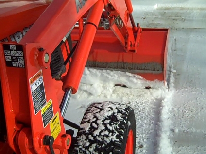

A topic that has been hashed over many times but maybe some different approached. First, this is on concrete and asphalt only, it does not apply to gravel.

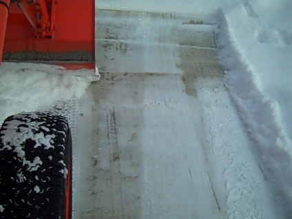

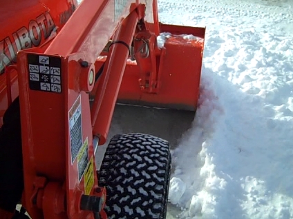

In my area, mid Michigan, we typically get 100" a year so I figured a rear blade alone would get me through as we maybe get more than 8" once every other year. I took the load off to help with maneuverability around the cars. Also plowing three other driveways (for pay). I am averaging $60 to $75 per hour with loader only running in mid range @ 1800 rpm. I can go much faster but I have a cast on my left hand at this time.
So, because of global warming, we get 50" in December, an all time record. About half way through the month I realized that the rear blade was not going to handle the snow banks so on goes the loader. Then we get a 14" dump and I find that the loader pulls the snow away from the garage door better than the rear blade because I can see the door and ease up to it much easier. (The hydro drive can't be beat in a situation like this.) Also since none of the driveways are longer than 100', the loader bucket does just as good or better than the rear blade. And the loader can pile it up where the rear blade can't.

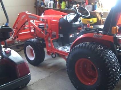

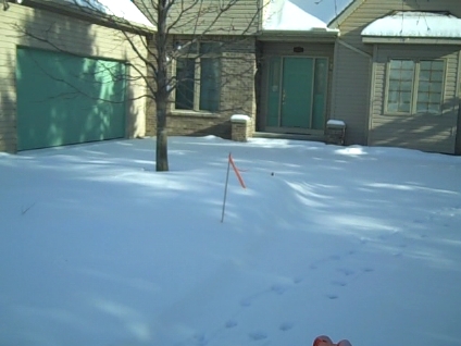

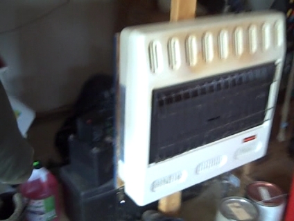

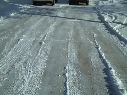

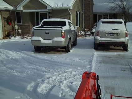

The first photo show pulling show with the loader, front edge curled down. The second shows the same thing. The third shows the pulling results. Number four shows my helpers. They watch my back to keep me safe from the rabbits, squirrels, ducks, geese, deer, ect., and they do a good job too. The fifth shows one job where it is difficult to put the snow and the sixth shows it cleaned. Seven shows my storage security, eight shows the chain bucket and the last shows the pre-heater. The tenth, out of sequence, show pushing snow with bucket edge tipped down. A work of caution here. Go very slow on concrete as you will find the expansion joints, they can cause a sudden stop.

Very good job with the fel. Looks as good as if it were done with a blower. I have had enough of the snow already..... just keeps coming. Just a little over 8 feet so far this season and more on the way. Didn't see how much the storm for tomorrow is going to bring. Only enjoyment I get out of the snow is the seat time in the tractor. I have had a couple of friends call me and asked if I would trailer my tractor to their place and blow their driveway. Probably would have if I had a 14' trailer. But 400 feet of driveway not to mention the outlaws place behind us is enough.

My 1400' drive is gravel, but I also use my loader. I tilt the front edge up 1/2" or so and leave just a little snow. After that I tilt the front of the loader down (not as much as the OP) and back drag in float position. I have to go over areas more than once, but it does a pretty good job. I am always looking for better ways.

The pre heater is a 30,000 btu natural gas heater. The entire garage is heated as my spouse uses it as a smoking room. So the temp is seldom below 50 F. The tractor starts pretty quick.
