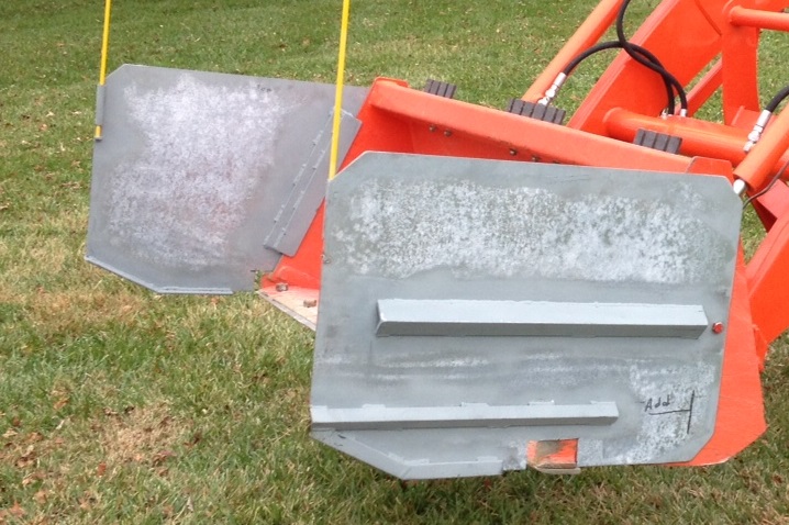

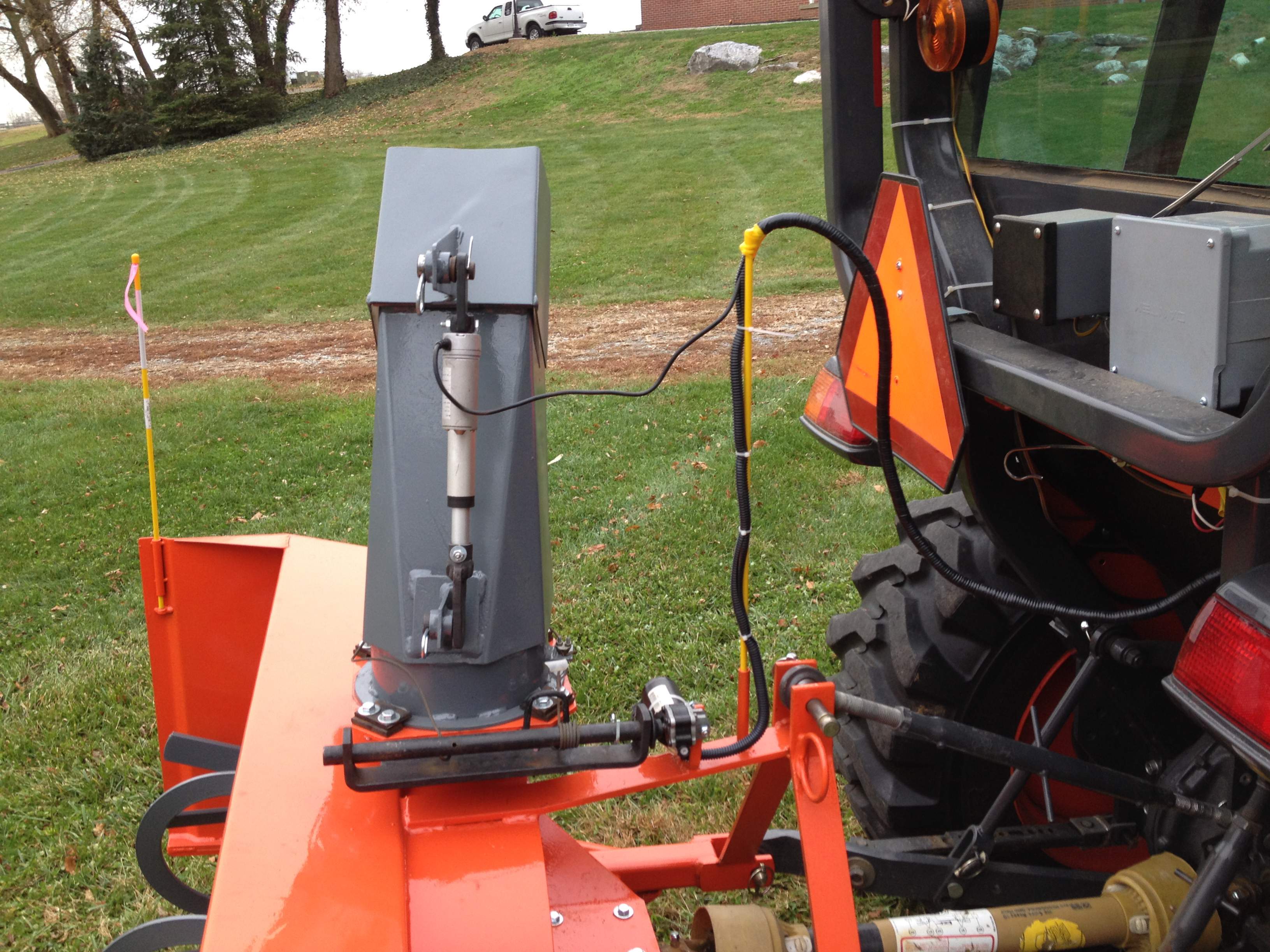

I made side extensions for the FEL to use it as a pusher. They attach with one bolt each, so it's easy on and off. Picked up a used 64" Pronovost rear blower and wired up a linear actuator and car seat motor for cthe chute control instead of adding remotes. It all works well, but without the cab it wouldn't be as much fun.
