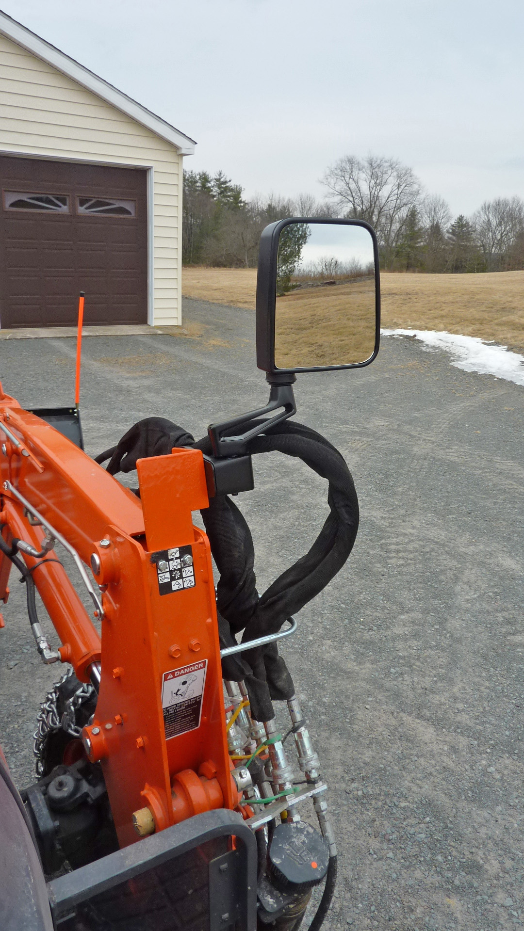

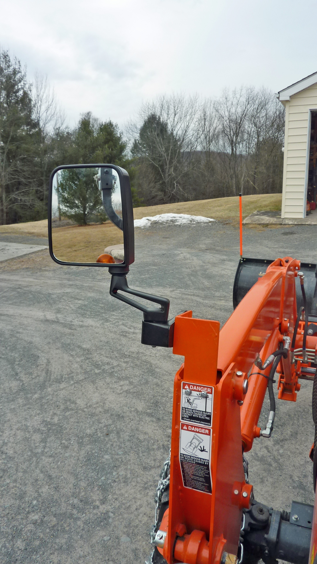

I know, I know, twisting and turning while blowing can be awkward, but there is a trick to doing it not turning your head... I turn and sit on the seat at 90 degrees. It's actually comfortable if you do it right.
When using my rear blower, I have these Jeep Wrangler mirrors bolted to the FEL support tower:
With a little practice, I don't have to turn around at all.
