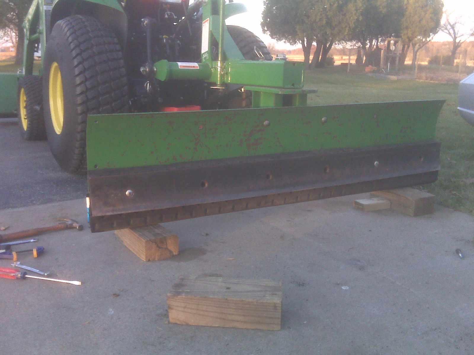

Not trying to be critical of your idea as it works okay, but I used a double thickness of the exact same thing as a bottom edge for my Frontier 1072 rear blade for a few years, it's easy to cut and drill but wears very poorly because the rubber is so soft. Earlier this year I found a complete round truck tire cap along the roadside, it was a b---- to cut using a Sawzall with a metal cutting blade and an even bigger b---- to drill thru because of the tiny brass wires but once on, it's as stiff as metal. It also takes much longer bolts than the OEM wear bar used to fasten on, but I only have to do this once. The cap is about an inch and a half thick, odds are it will outlast me.

Totally agree this stall mat idea is new to me and I am sure I will have many lessons learned from it as I use it more. One of the things that I actually like is the softness or should I say - "give" - of the material. Since I am plowing what essentially is pea gravel I want the plow to kind of roll over the gravel with a layer of snow - As you see I had some real issues with the pipe idea and so far found this clearly is much more forgiving, it does not effect the gravel and make a nice clean path.
JD - I like your truck tire cap idea but it would be too stiff for my liking - then again I am sure if I mount it with enough overhand it would give. As far as wear - yep the tire should outlast the mat by a couple of hundred years :)

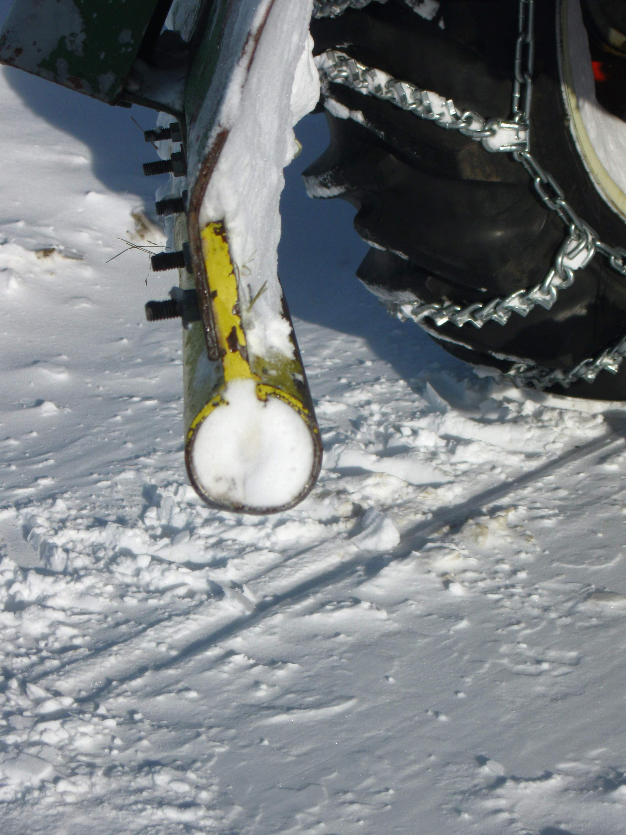

I made this for my back blade back in 1989 and use it all winter here in Western MT. It's made from a 2 inch sched 40 pipe and a 3/8" x 6" steel plate both the the width of the blade in length. I split the pipe lengthwise, put the plate into the pipe (you can't see that because of the snow in the pipe) and welded it full length. I drilled holes to match the blade. In the summer I put the grader blade on and when the snow flies I switch to the "snow edge". The large radius of the pipe doesn't move gravel around but it moves the snow. It's still going strong after 22 years.

Very slick and very permanent! If we had winters like in MT, I'm sure that your 'fix' would be tried here too. That's what I love about this forum-lots of good ideas to choose from!

I did something similar, but instead of bolting on, I made brackets that sandwich the cutting edge and two hooks that go on top of the blade. there are chains with plow bolts welded on the ends that go up vertically through my "hooks" which when tightened down hold the pipe on. the brackets that sandwich the cutting edge are in between the cutting edge bolts, and prevent the whole thing from sliding off either side. it works great, and is easy to remove. I can get some pics maybe tonight if anyone wants to see how I did it.
