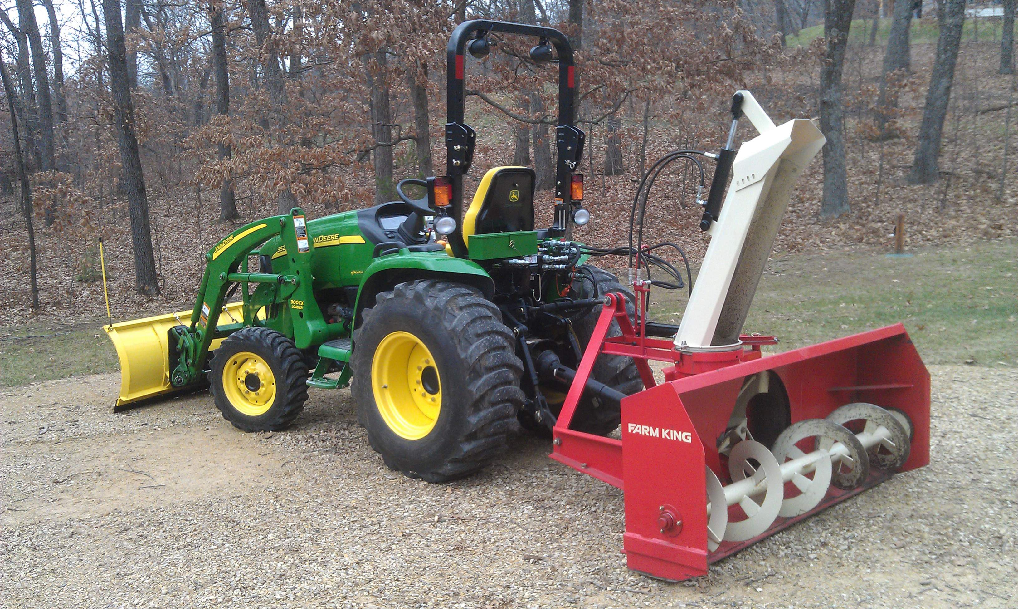

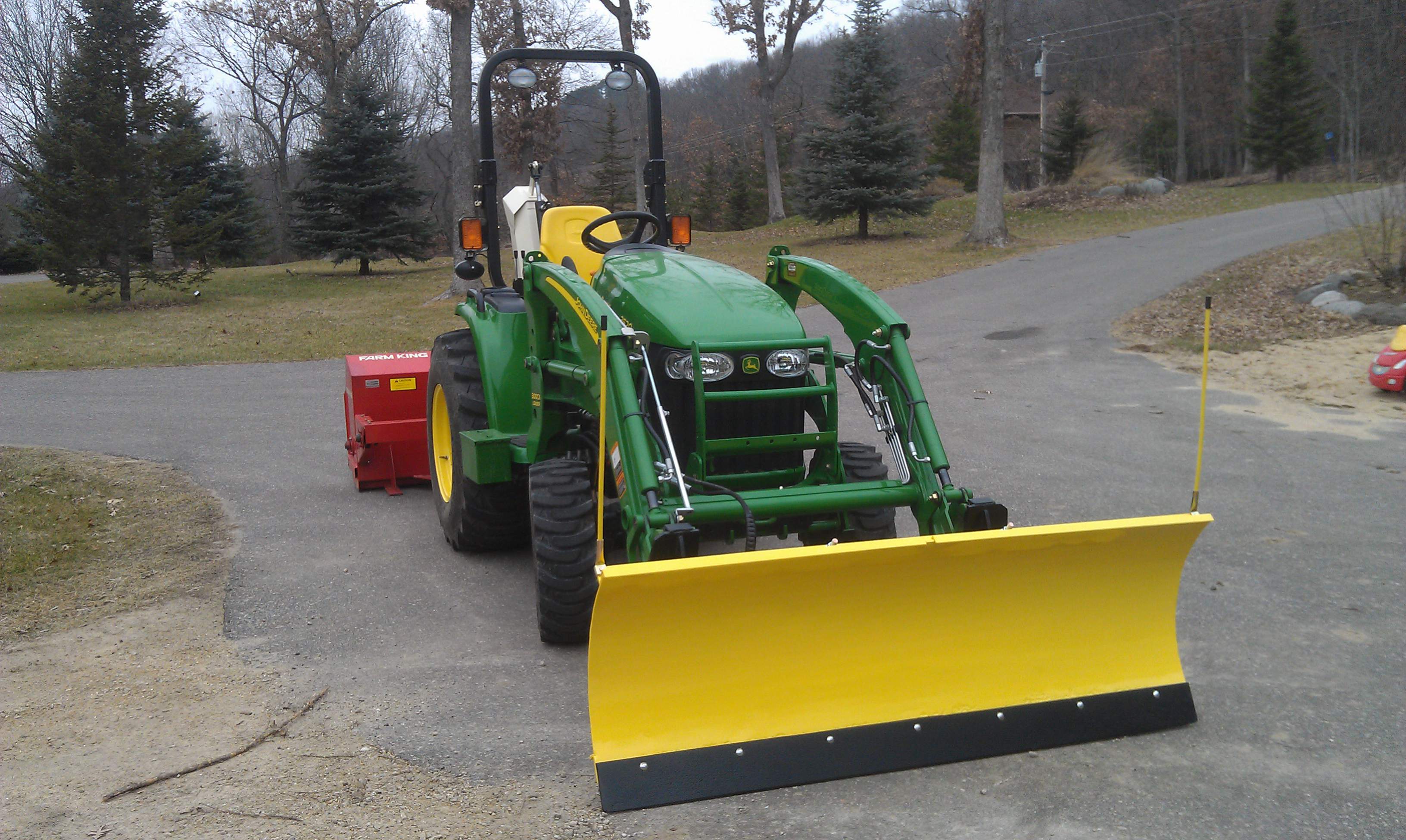

one word of caution: I wouldn't buy one made for a skid steer as they tend to be much heavier and you will have a harder time pushing/turning. Many members on this site have converted old truck plows since they can be had for a much lower price than buying new. Just do a search on here and you will see what I'm talking about.
I Myself built a loader mounted plow from an old 6' meyers. Since I have the blower I mainly use it for clean up.

OK guys, have an opportunity to buy a snow plow that was used on a small pickup truck for $250. Believe it is 72 inches wide. I was told that I could just purchase the quick attach plate and just have it welded to the snow plow so that I can use it with my loader on my CT235. If anyone has done this and can give me any direction as to how to measure exactly where it should be welded onto the plow? If anyone has pictures of this that would be great. This route would save me a bunch of money!
