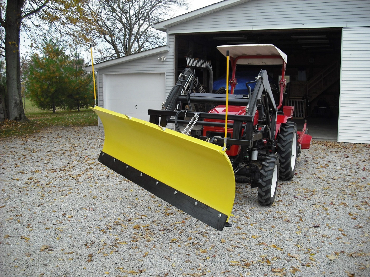

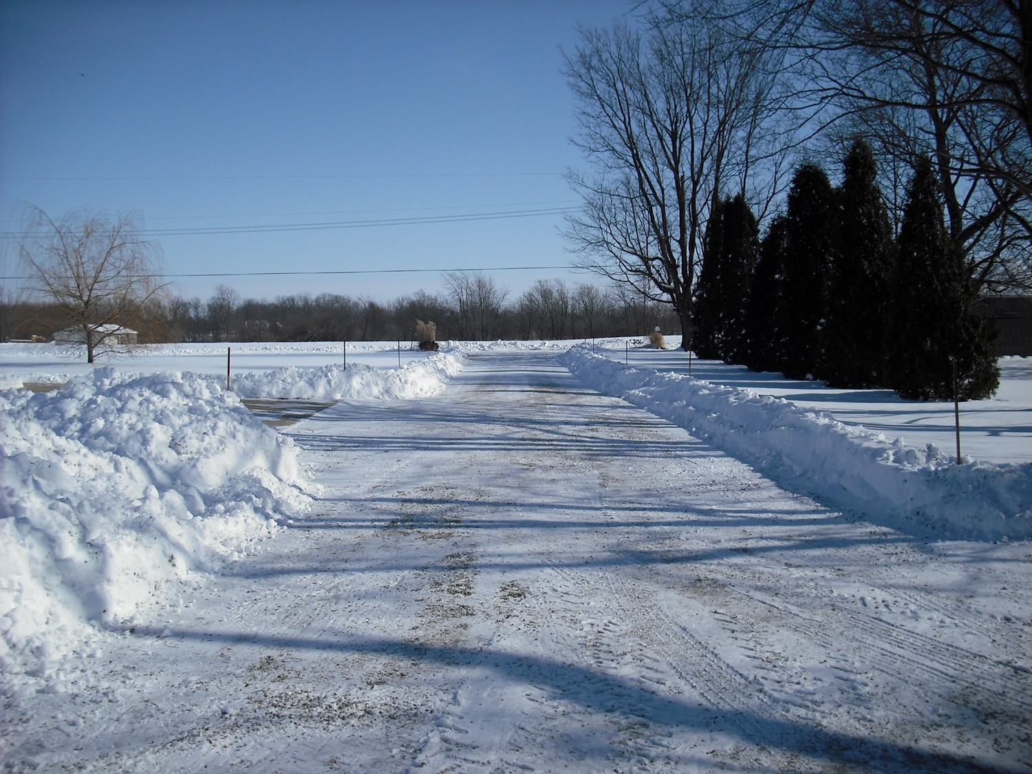

I run a 6.5' Meyer on my Jinma 284 with no chains and it does fine. Its 28 HP. It handled 18" snow in the picture no problem but I have since loaded the rear tires.
Chris
