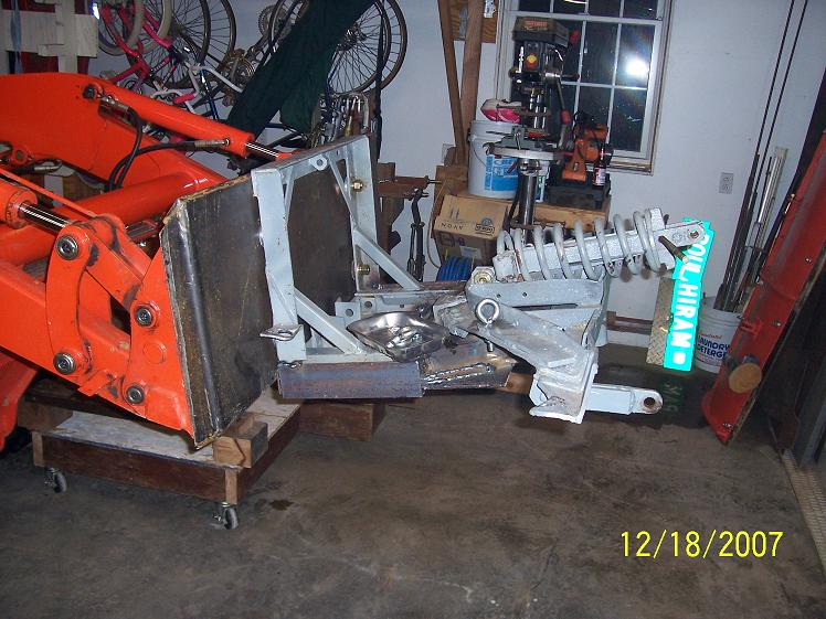

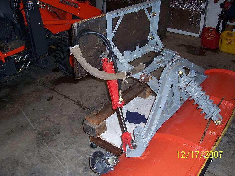

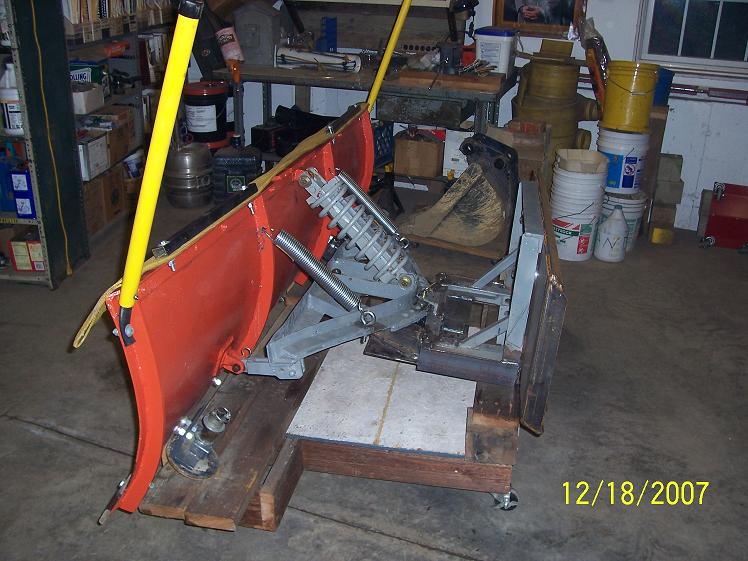

The latest project to come out of the shop during this snow-less CT. winter.

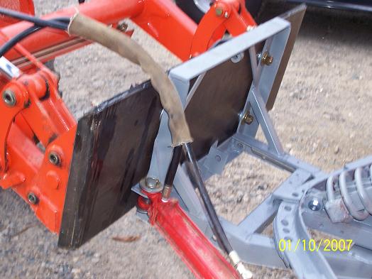

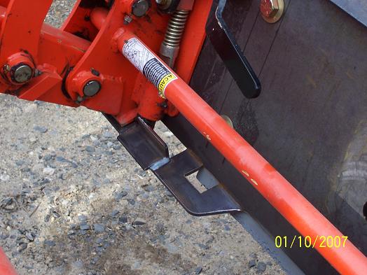

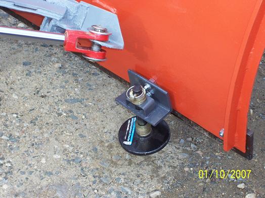

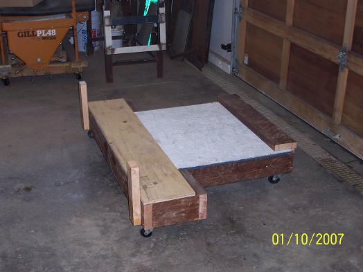

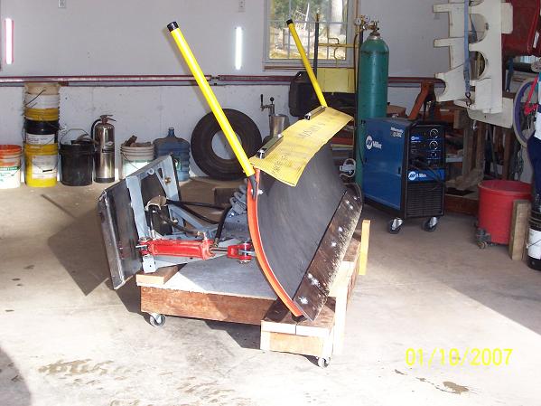

I was at the local dump in November, and came across an old 7' snowplow w/frame that had seen some rough use. I tipped the dump guy $25.00 and took it home to see if it could be made useful again. I un-assembled it, stripped it, welded some repairs to it, repainted it, and added guide markers, skid shoes, a snow blade rubber flap, and a hydraulic cylinder for power angle. I bought a skid steer universal plate on eBay and mounted the frame to it. I needed to weld 2" angle to the plate pin holes to keep it secured.
I have about 30 hrs of work & $200.00 of materials into this project. As I finished this today, we finally had some snow flurries today. I had been plowing my 450' driveway with the loader bucket & rear blade, which took an hour+ to clear. I am hoping this will speed up the job. This is mounted on my Kubota L-39. Now I will be able to leave the backhoe on for better traction.
Here are some photos of the finished project. I also made a storage frame on casters to move it around the garage.
"Blizzard of 2007", I'm ready for you.

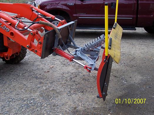

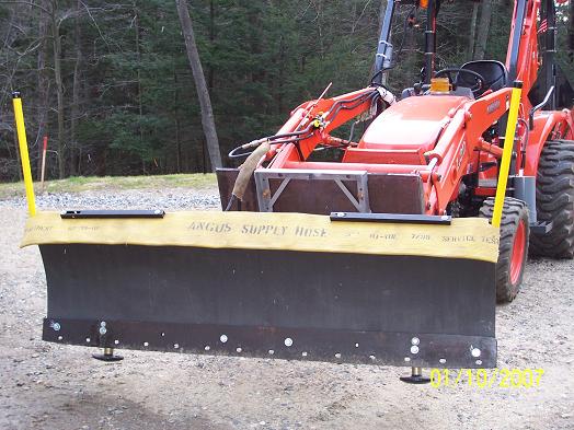

Finally got some plowable snow to test out the snow plow.
The area was "dumped on" by 3" of snow Friday night. I worked a dayshift on Saturday and plowed & sanded the drive last night. With the recent cold weather, the ground and driveway are now frozen.
The initial experience using the plow on the loader frame is that the bucket curl angle must be played with while plowing in the "float mode", or the blade will constantly trip forward on the gravel drive. I imagine that as I get more familiar with the technique, along with fine tuning the skid shoe position, plowing will be smoother.
As I had been using a rear blade, it is easier on the neck looking forward than backward.

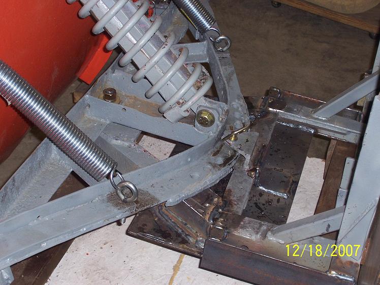

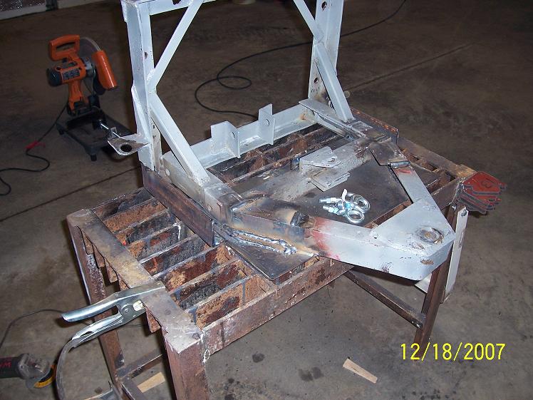

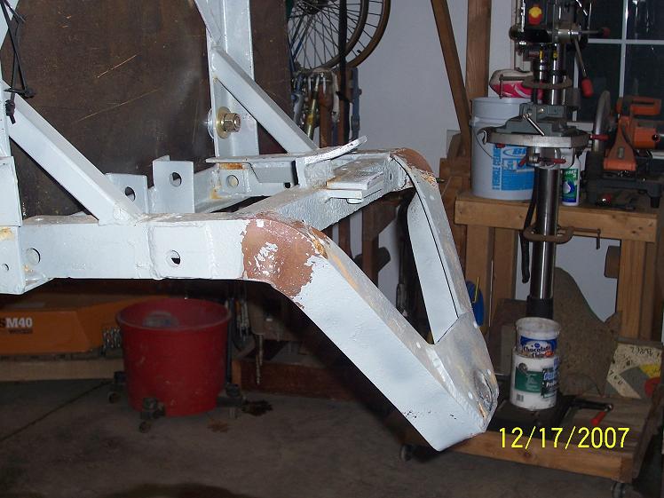

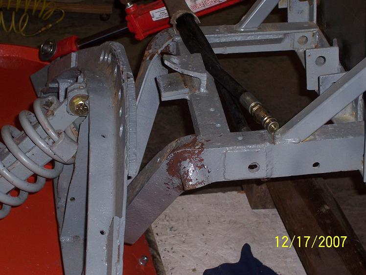

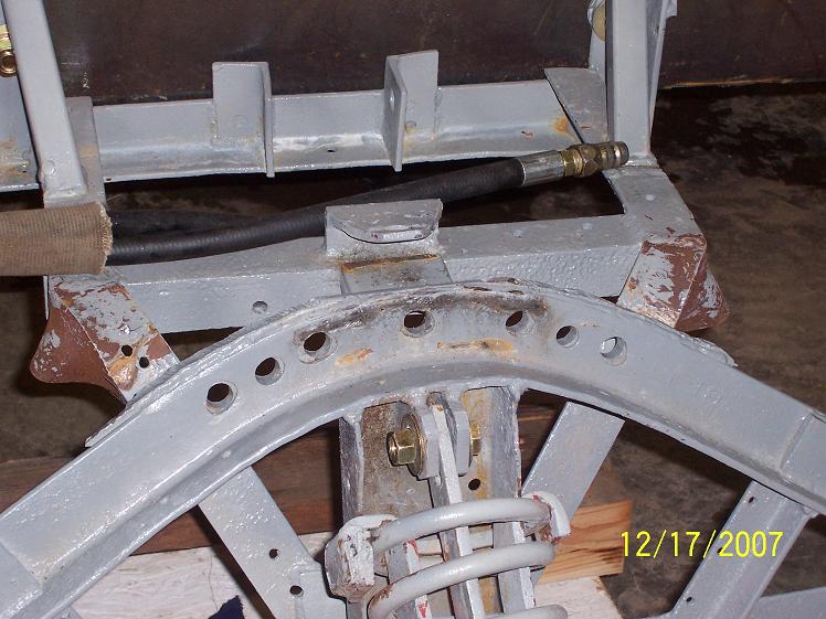

An update to the snow plow story from last year. The past two weeks have given me more plow time than all of last winter. One problem was that I had to constantly adjust was the plow angle/bucket curl to avoid tripping the plow. Too much curl meant leaving 2+" of snow on each pass. I had the "brilliant" idea to limit the plow tripping by using a chain to limit the plow from tripping. It worked well for 30 minutes until I caught a stone on the drive way.
With the chain limiting the trip, My 7000 lb. tractor simply bent the plow frame 90 degrees at its weak point. OOPS......
Today, I had the time to repair and weld up some reinforcement to the frame. I had to disassemble the plow & frame, and rebuild it.
I added two additional trip springs to the center spring. I'll give it a whirl tomorrow and hope it performs as required.
The one casualty is my angle cylinder, which moved minimally when I reassembled it.
It appears that the cylinder rod was bent. I think it was around $70-80 bought at TSC.
The lesson learned is don't defeat the protection devices.
