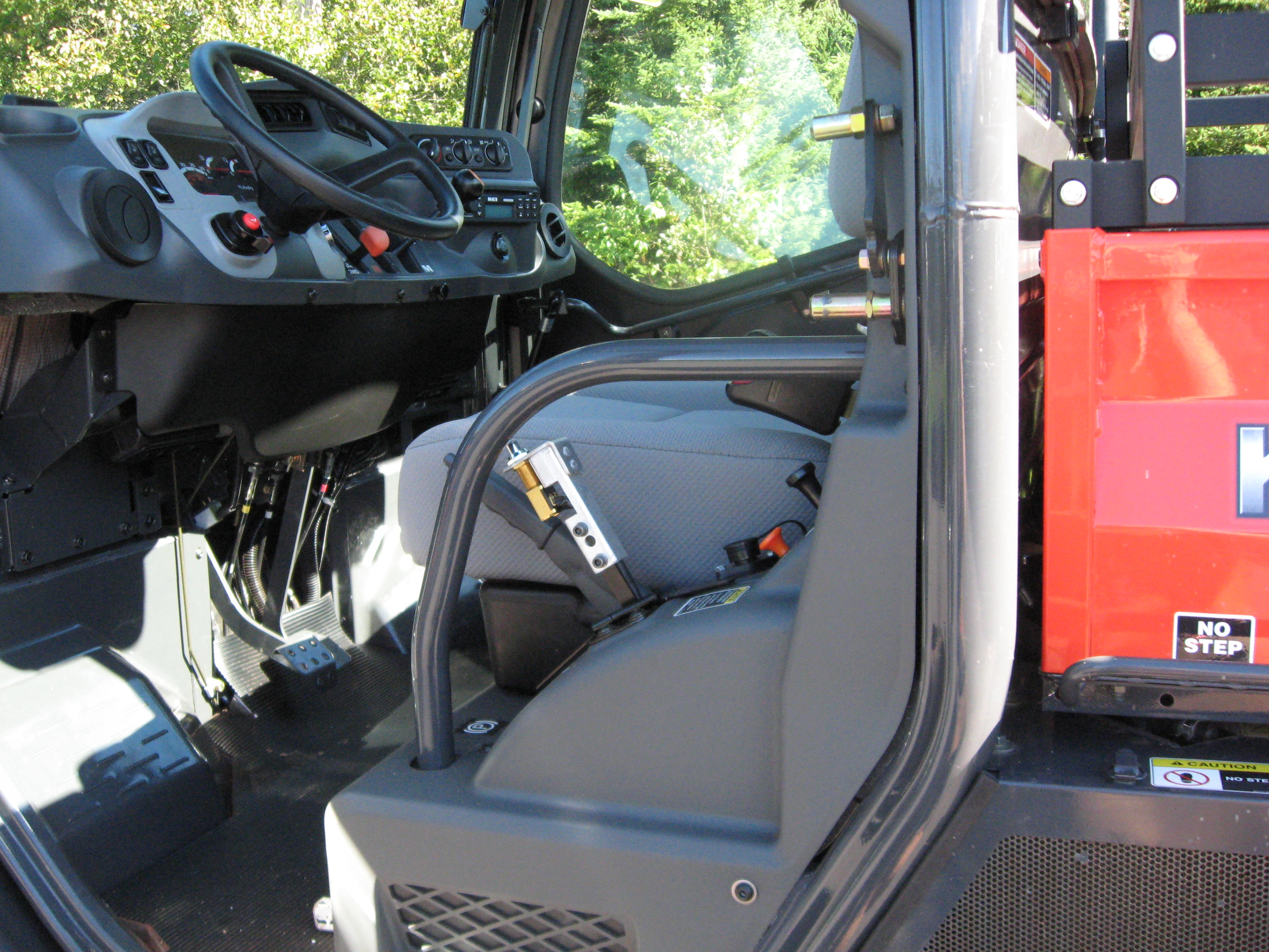

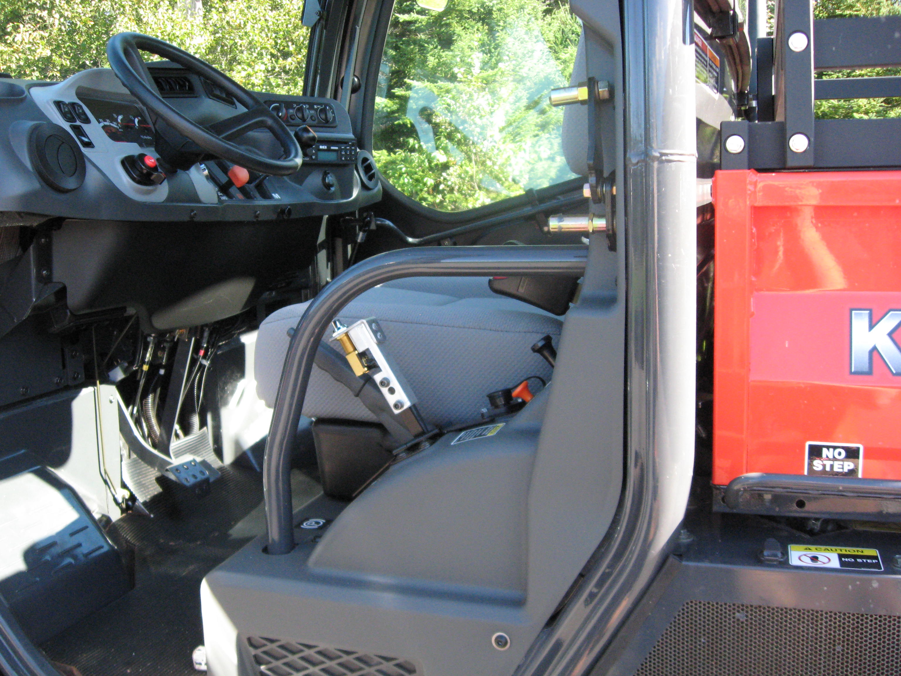

More pics. I know how you guys love pictures.
Not a very fancy switch setup but it works great. Press the button and you are controlling the left and right swing of blade. Don't and the lever operates the up/down cyl.
The other black connector just back of it is the remote for the winch. I don't install the dash switch because people have a tendency of pressing buttons and winding up the winch too tight. To use my winch you use the remote lead. Makes for less wiring as well because you don't have to run wires to your dash.
Question. Why on a plow do they use two single-acting cyl. when one double-acting would do?
Single-acting cyl. need to be flushed from time to time. If it were double acting the flushing occurs automatically.
