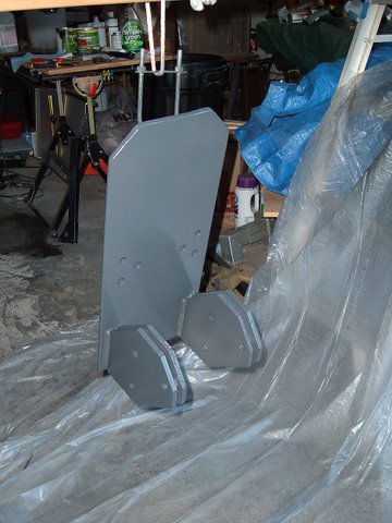

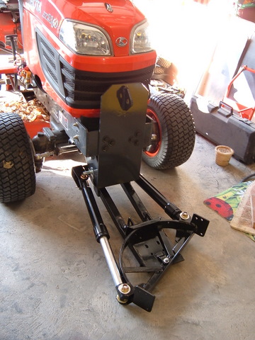

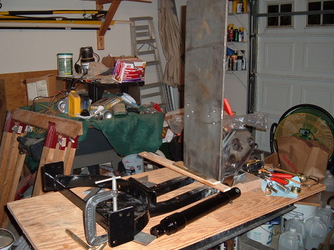

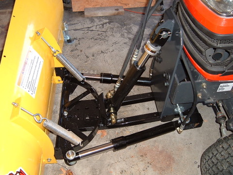

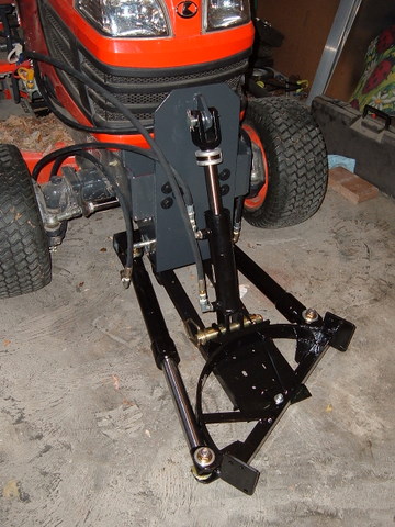

I purchased a Bx 2360 back in March and should have included the 60" front blade at the time of purchase but figured I had spent enough. During the summer I priced the blade and mount at $2100 so I started looking for a short snow plow like off of a Jeep and couldn't find one nearby. I wound up buying a Moose Country plow and a universal mount. Pics show the journey over the last few months. I estimate I spent around $1200 (not counting the plasma cutter).

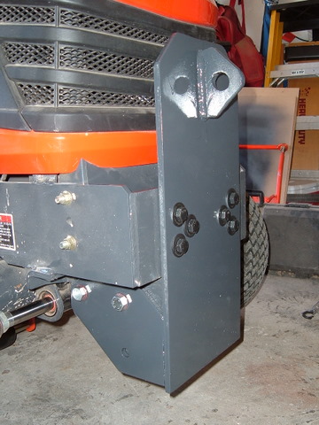

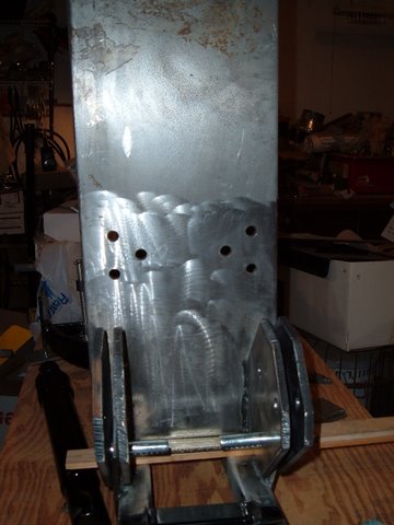

Yes, the first pics mainly show my messy garage. The large plate you see bolts to the 6 holes in the front frame. The large tabs coming off of it sandwich the frame rails where the front MMM clips in.

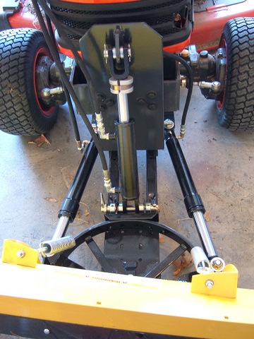

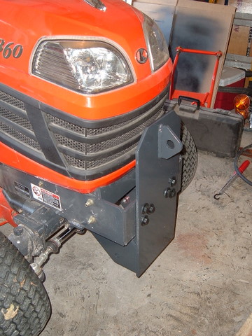

Next project is to clean the messy garage so tractor w/plow and the wife's car can fit. More or less finished the snow plow. One of the hydraulic hoses didn't dress in very well so I need a different one. I need to reinstall the ROPS and maybe add some lights to it. I will try plowing without chains and then decide whether to buy some.

NICE! Figure you saved $800 or so? I don't see any "weak" point on that - Should work as long as the tractor!
   / Snow plow project #7
Nice fab job. Keep in mind that those plows were designed for and ATV and your tractor weighs at least twice that of an ATV. I venture to guess that when you have good traction you will have plenty of power to bend that plow.

I would be a bit concerned about your hydraulic lift cylinder. Most snow plows are lifted with a chain, not a solid connection so they can bounce up if they hit something. If you hit a buried curb or something, it will bend your frame, bend the blade or trash your lift cylinder. You might think about a flexible connection.
Otherwise, great work.
