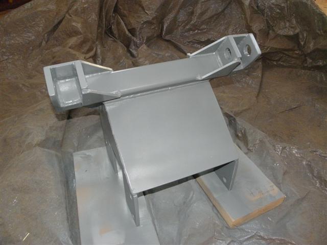

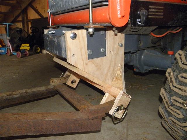

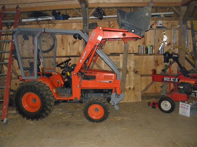

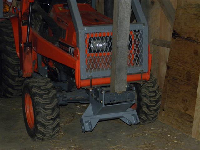

Hi all. Just finished installing a snow plow mount on my tractor and I can't wait to try it. Pictures are below. I can't take credit for the metal work, that was done by a friend. I mocked up the wood template. Sent it to him to fabricate. I made minor adjustment to the holes to bolt it to the tractor, painted it and attached it with eight Grade 8 1/2" bolts. I'm hoping this will help with steering with an angled blade compare to hanging the plow off the front of the bucket. :D

Very nice. Thats quite the brush guard you have there, reminds me of a n.j. forest fire truck. Are you going to leave the FEL on while the plow is on and use it to lift the plow?
   / Snow plow mount on Kioti LB1914
Thanks... the same guy did the metal work for the cage. Yes, I'm going to leave the Fell on. I just leave it all the way up, put a chain on the back of the bucket and dump it half way to lift the plow. Curl it to put the plow back down. I like having the extra weight of the fell on the front wheels to help with steering.:thumbsup:
