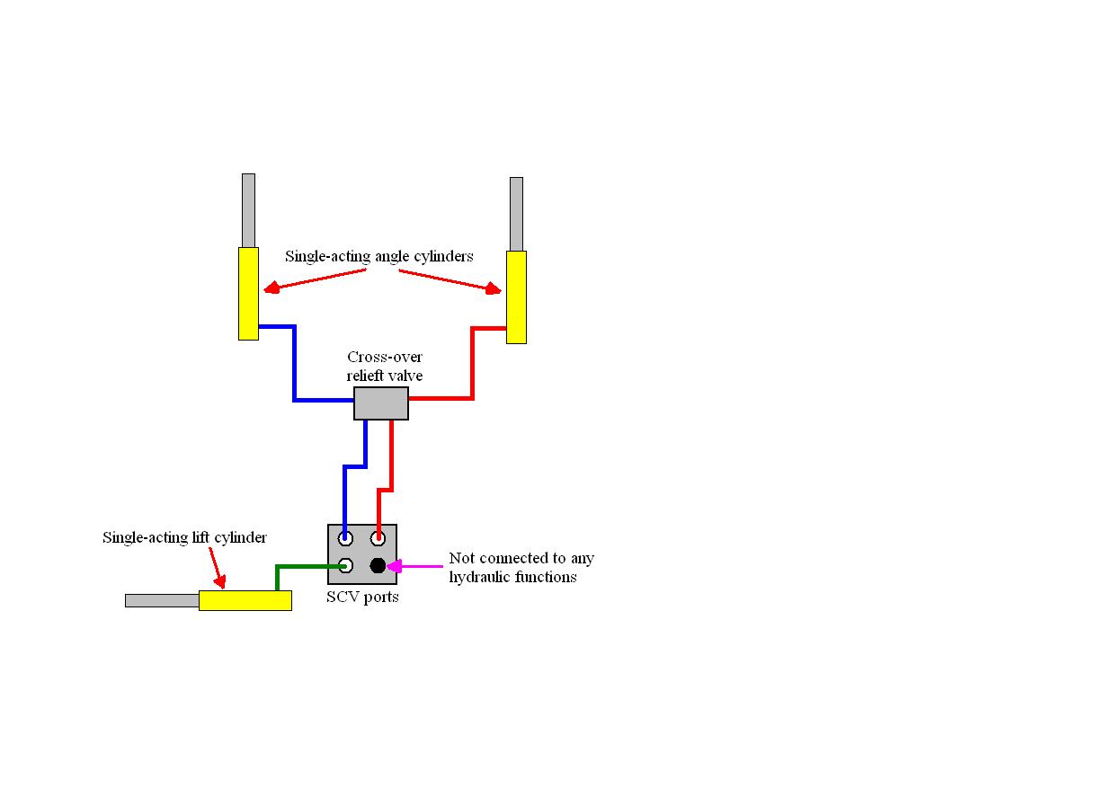

Hello all,
I just picked up a used Meyer snow plow blade that I plan on fitting to the front of my JD2520 by means of custom made frame mount. Now I know from past posts that I can hook each single-acting angle cylinder to the SCV's dump/curl ports, however can I hook-up the single-acting lift cylinder to the SCV's "raise" port and leave the SCV's "lower" port disconnected? If I did this, would the oil trapped in the base of the cylinder be able to travel back to the reservior when the joystick is moved to the "lower" position.

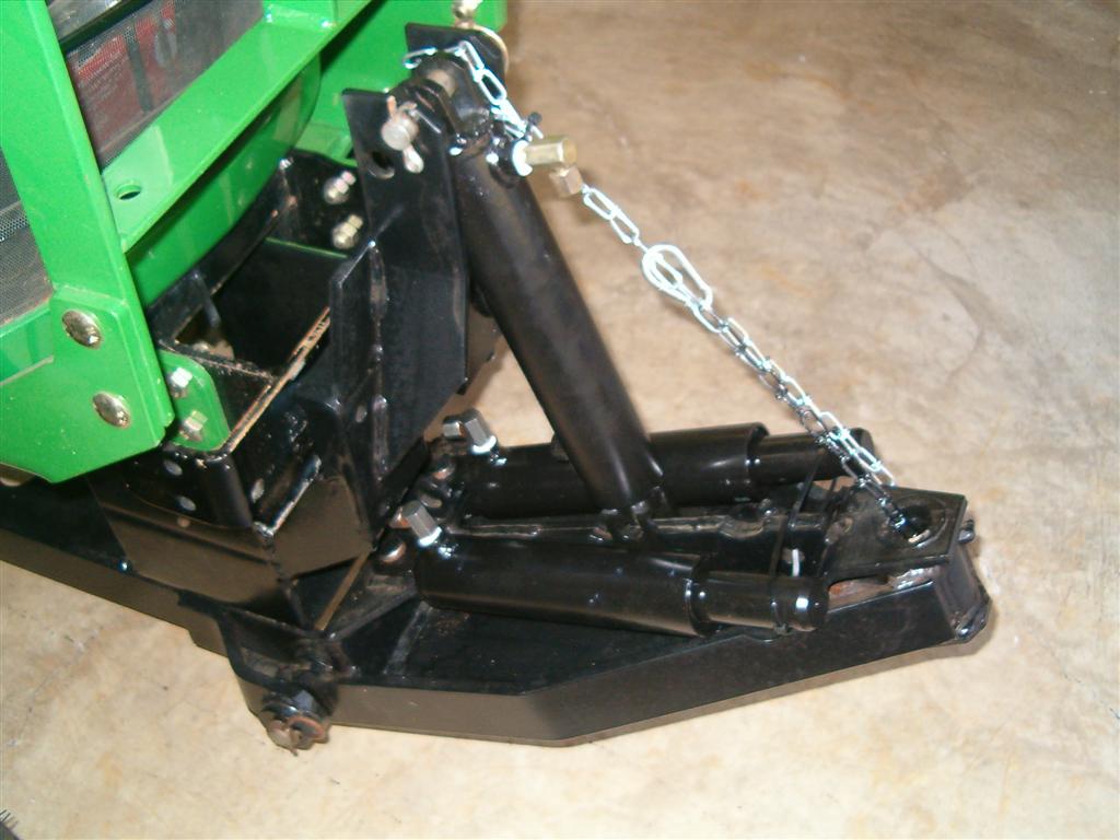

Yes it should. However I recommend using a double acting lift/drop cylinder in this position because its handy to have downforce on the plow when chewing through ice covered pathways, especially when backing up with the plow down. This is useful when plowing the cement part of my driveway when cars have been parking on it for a while. I also built a custom frame for attaching the truck plow (as you can see). Other advice is to keep the plow blade as close to the front of the tractor as possible. This reduces the tendency for the tractor to be steered by the angled blade instead of the front tires. BTW: Leave pleny of room for adding front weights as necessary.
/ Snow plow hydraulic question #3
Yes, it will work fine-but when the stick is pushed forward to lower the system will go into relief because nothing is plugged into that port.
I also agree with ZZ that having downforce is nice...but you can always add a DA cylinder later.

I was planning on using a chain to lift the plow, like a regular plow set-up, but I may end up going with a set-up like your's, in which case I would use a double-acting cylinder to take advantage of the down pressure feature.
If the system goes into full relief, the weight of the plow should collapse the lift cylinder- correct?
Thanks for the replies guys,
Ryan
Yes, that is correct. Just don't be "alarmed" when you hear the engine bog down a little.

The connection of the 3 hyd cylinders works just fine the way you plan to use it. And there is no 'load' on the engine from hitting a relief when lowering the single acting cylinder conencted to the plow with a chain. At least not on my JD 4300. I worried about the same thing, but didn't happen.

No connections here...I found my #380 plow (for the old x55 series tractors) on Craigslist and modified it to fit my machine (see picture below). The 54" blade is what JD has to offer along with the front quick-attach. If you can weld/fabricate( I assume you can) than you and mount that plow off of the front bumper of you tractor.
