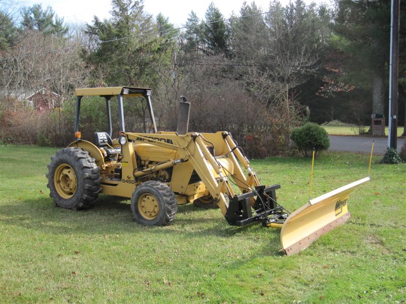

Builder
"Nice. Looks very simple & easy to hook up."
Thank you..great for pushing back snow banks. :)
