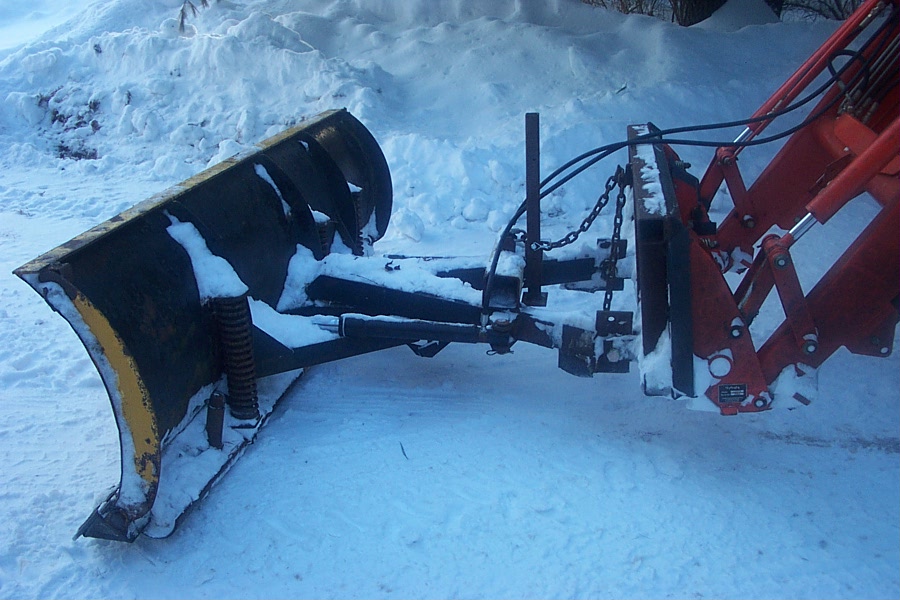

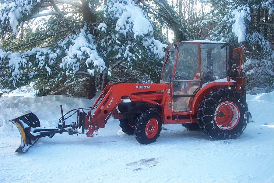

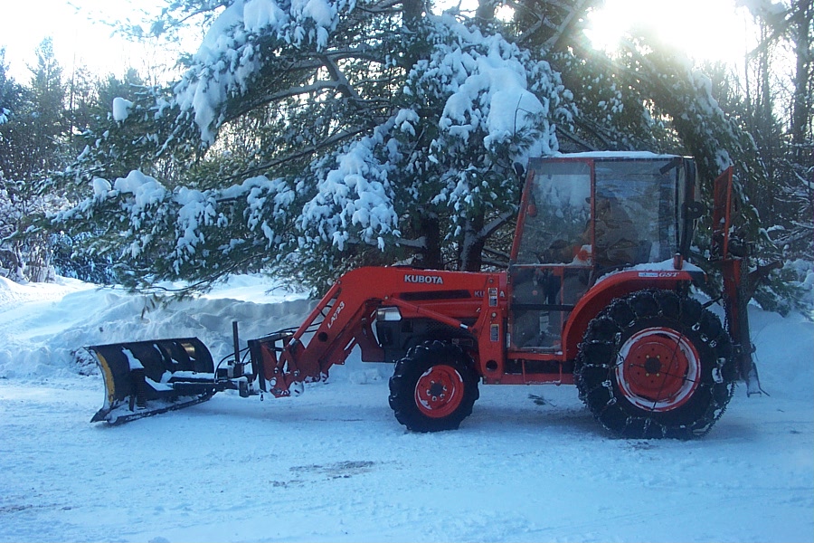

/ Snow plow cylinders? #9
This is what I did and the rear remote operates the angle cyls.
