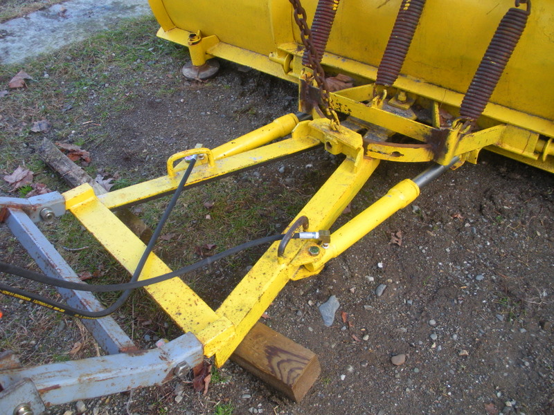

Sorry, I know this has been discussed LOTS, but - I have an old Fisher plow blade with two SA cylinders. I have it mounted up front on my Kubota 2350DT and I would like to tie into the hydraulics, adding another valve to control the plow angle. The hydraulic circuit on the tractor goes through the power steering to power-beyond the FEL. I am thinking I can add another valve after the FEL to control the plow angle.
I have a few questions.
1) Can I even install a valve after the FEL to control the plow angle? That is, does the two spool FEL control valve have to have power beyond to do this?
2) Assuming I can install a valve after the FEL, what kind of valve? I think I need a single spool valve, but then things get murky. Closed center? Open center? Relief valve? Crossover? I can't figure out what applies and what doesn't.
3) Does the new valve need power beyond, or is there nothing "beyond" the new valve that needs power, since it just returns to the tank?
I need to be sure I'm doing the right thing, since the valve and hoses will cost more than the plow did. This needs to be as low-budget as possible. It's so low, for the last two winters I have angled the plow manually, but that is getting old. Or, maybe it's just me that's getting old.

I'm making a few assumptitons here but If your mounting the blade to the loader and you don't use your bucket for a mount for the blade, you could buy a couple (pairs) of quick connect hyd. fittings to put on the lines that operate the dump function of the bucket and use that for angling the blade pretty cheaply.:thumbsup:

I run my plow off the loader valve, angle and up down. Use car brake lines to reduce the flow. Works just peachy. The 2 single acting cylinders are mechanically linked and thus work like one double acting cylinder. Connectors from TSC. Even though the cylinders are probably rated at only 1000 psi, I push my 2000 psi thru them gently and never had a problem in 10 years.

Thanks much, I like the sound of this. In my cheapo mode, I simply have the plow slung under the bucket with a chain to a hook on the back side of the bucket for the lift. I have the bucket curled way in when plowing. I welded up a crude adapter on the frame of the tractor, and that pushes the plow. I wasn't sure about switching the dump spool over for the plow angle, but that sounds like an option. I saw discussions on "regen" and I thought I should stay away from the loader valves for that reason. The bucket would have to stay in position while plowing (I guess it would - the plow weight would tip back on the bucket even if it tended to droop). The loader dump valve has a "dump" detent for quick dump - does that matter? (I could just avoid it manually)

Just to finish up this thread. I obtained a couple of Snap-Tite connectors (from snap-tite.com) and 1/4" hose and then plugged into the FEL curl lines on the loader valve. Lo and behold, I now have hydraulic angling of the plow! Had I known it was this easy I would have done it right from the start. I've spent less than $300 for the entire plow rig, and it all works just fine.

Not quite. TWO SA cylinders of the same size have the SAME volume.
Of you substitute that with ONE DA cylinder, The two functions are going to require different volumes of fluid. That means one was is going to be faster with less power, and the other slower with more power.
But that isnt the real issue. A standard crossover valve like used in a smowplow wont work with a DA cylinder. It appears that the one JJ listed MAY work with a DA cylinder?? I am not sure. But it would have to do more than just dump to the other side of the cylinder. It would also need to relief back to the tank.
What did you do for the crossover valve??? I assure you, at some point in time, you are going to need or wished you had one.
Not sure the exact geometry of your plow or size?, but most use a 1-1/2" hydraulic cylinder mounted so that the blade has a ~4x's mechanical advantage on the cylinder.
What all of that means is that if your tractor is capable of pushing with 1500 lbs of force on the edge of the blade (which is should be more than capable of), you would be pressurizing the hyd. lines and cylinder with ~3500psi right there.
What if your tractor can push more? What about shock loads? Catching a curb?
A crossover valve is highly reccomended:thumbsup:
