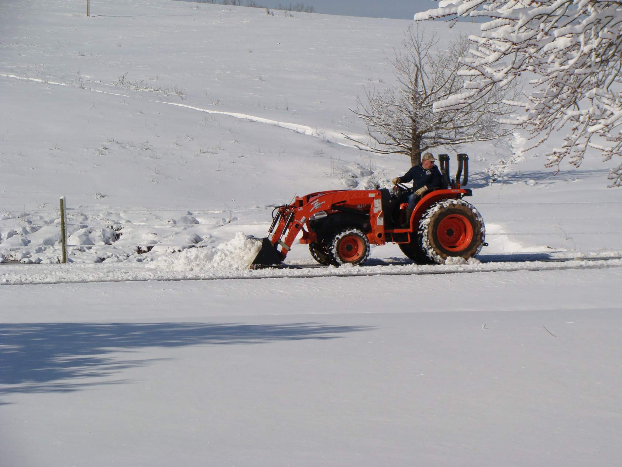

We recieved 5" in Harmony. After doing my drive ways and my neighbors I helped the county which never showed up.

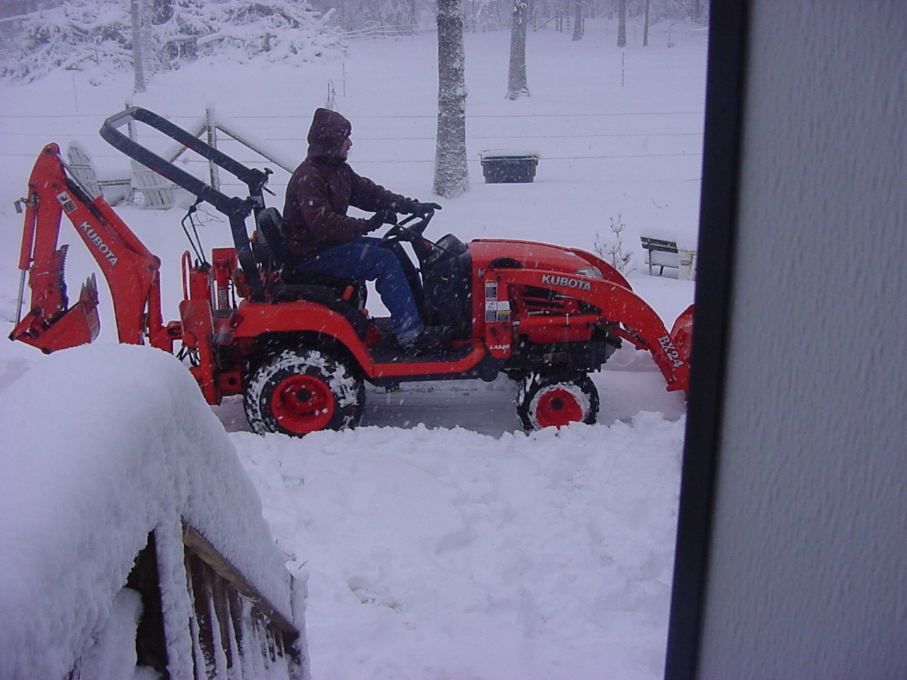

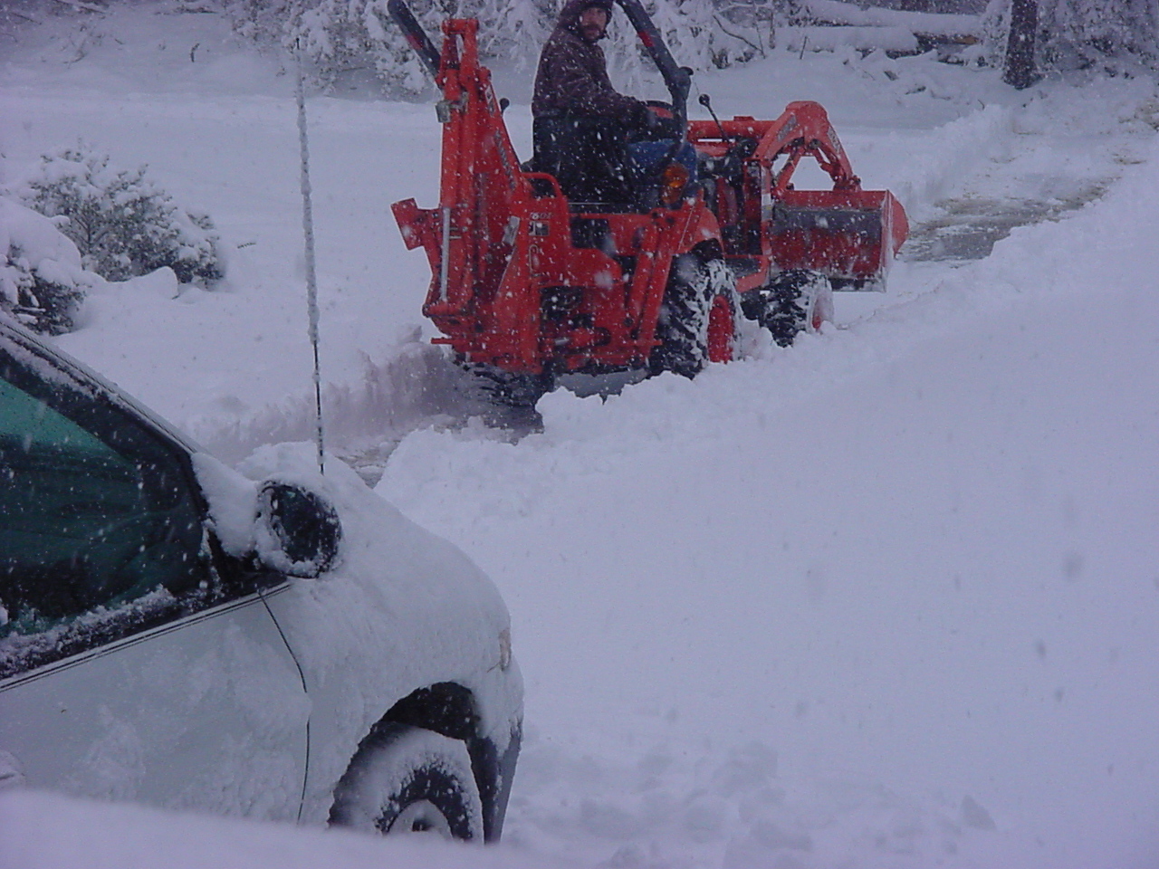

Doggonit!! I was hoping to not see any of this!!!
12-14" here in Southern Maryland.
Deano
