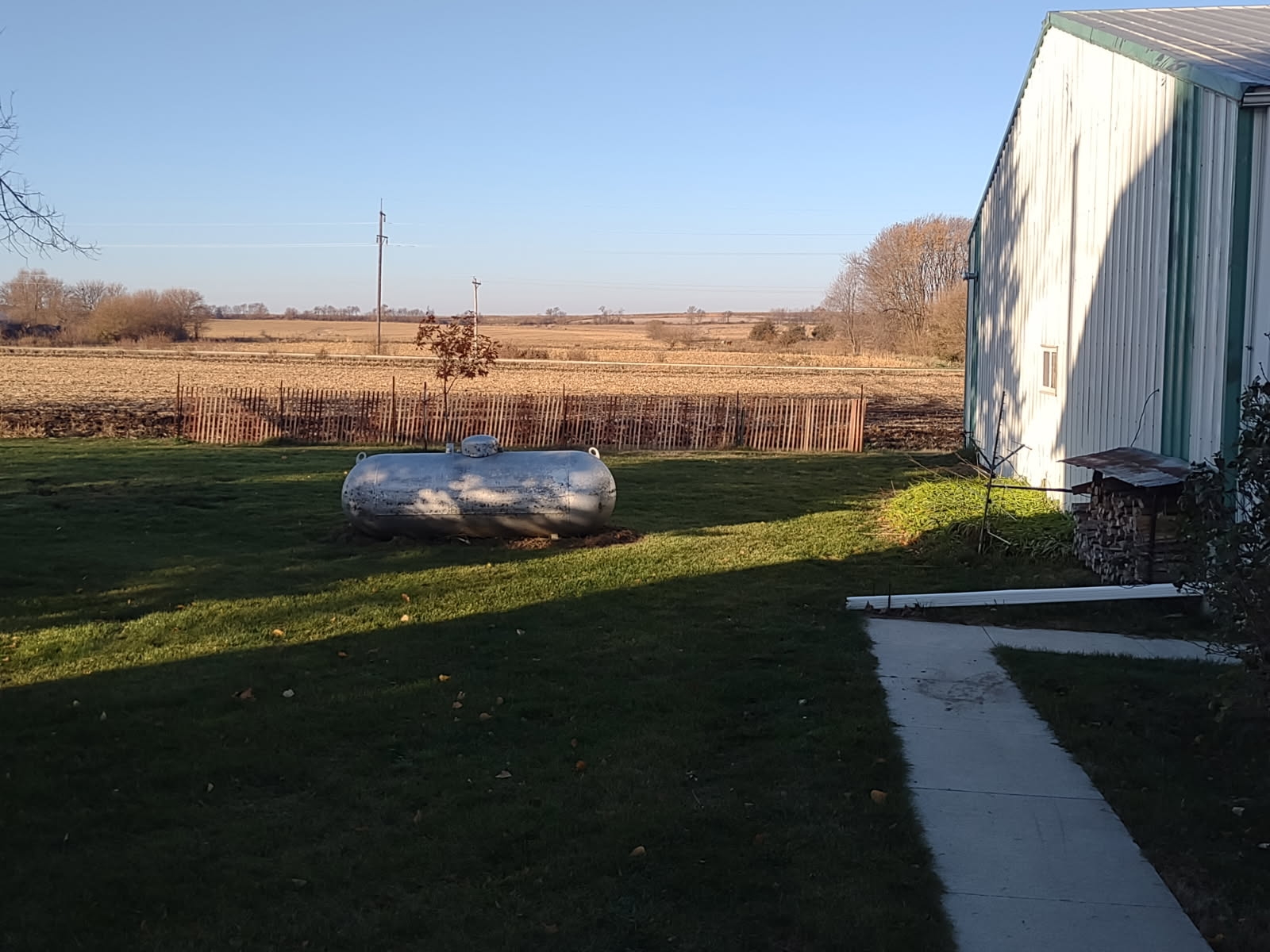

Last year, I put up 50' of snow fence - the plastic type. I used zip ties to secure it to the posts. It didn't last the season. The plastic webbing busted where the zip ties were. Not happy with the plastic type. I bought the wooden slat style for this year.
It gets taken down after winter, for storage.
My question is this: Should I use zip ties again to attach it, or should I cut short lengths of wire to secure it?

I never had much luck with plastic snow fence. It would either break or stretch out. I went back to the wooden slats and used these heavy duty zip ties:
They make a reusable product but they aren't as strong. Cheap enough to just cut & replace.
Eventually, I got tired of putting it up every year an installed a permanent PVC fence with a gate. May not be practical in every situation though.

I found out regular zip ties become brittle during cold months and winter winds don't help...I use wire. (y)

I got it up yesterday and used (US made) zip ties.

Update:
The zip ties did NOT hold up, against these Iowa 50mph blizzard winds. I'll get out (when it calms down/warms up) and fix it with WIRE.

Update:
After my wire ties and zip tie failures due to our Wyoming winds, I ended up running smooth fence wire on both sides of the snow fence, so the snow fence is sandwiched between the wires. Since I've done that I haven't had to repair it going on three years now. It survived last weeks 50 mph south wind gusts and later 40 mph north wind gusts. Before I was repairing it multiple times a year. "Here" you want the fence about 50' upwind of what you are protecting.
