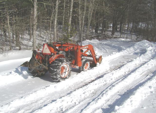

My place has paved slopes. Several years ago my tractor got loose on ice and came within inches of demolishing a garage. Since then I've used chains front and rear. Just simple link chains, no v-bars, no extra rings. They make all the difference - can go anywhere with confidence. The tires don't ever spin - the chains do leave little marks on the concrete floor, and on the asphalt - but they seem to disappear soon enough. For a less bouncy ride, the tire pressure can be reduced.

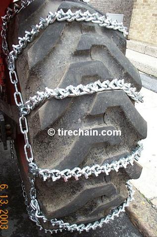

I don't normally need chains, but they do have one advantage. Mine are called, I think, ag double-ring, no bars, not sharp on any side. At middling temps when the snow is driven on (hard to keep the help out of the yard) and packed into ice, the chains help break it up. Ag tires in that case just drive over packing it more. That said, I don't put the chains on until I need them, since it's a heavy half hour's effort.
Jim

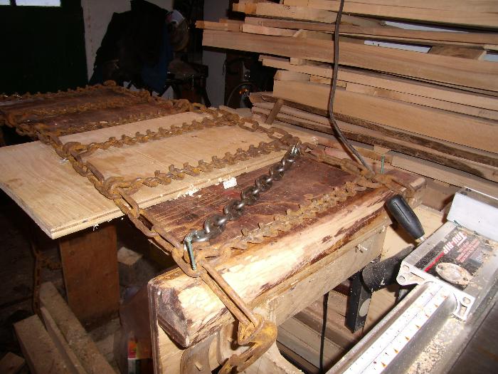

I work for a shop up in BC Canada... We sell stuff like grader blades, bucket teeth, loader edges, street sweeper brooms and..... tire chains.... I am the unofficial head manufacturer there... you have a tire, I can make chains for it...
with that said, I think the chains you are trying to describe are called Duo-Grip, a common kind of snow chain used on tractors
