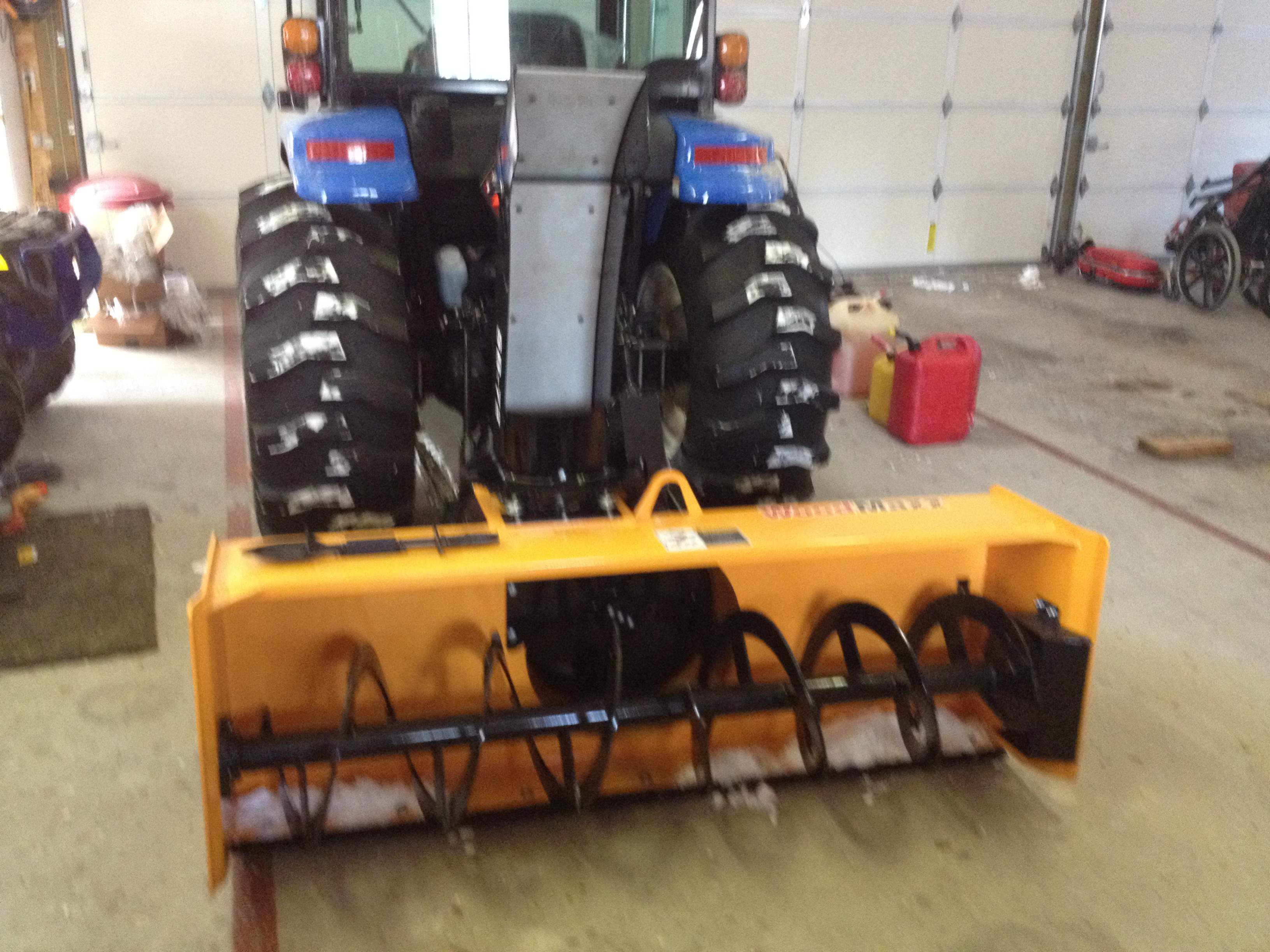

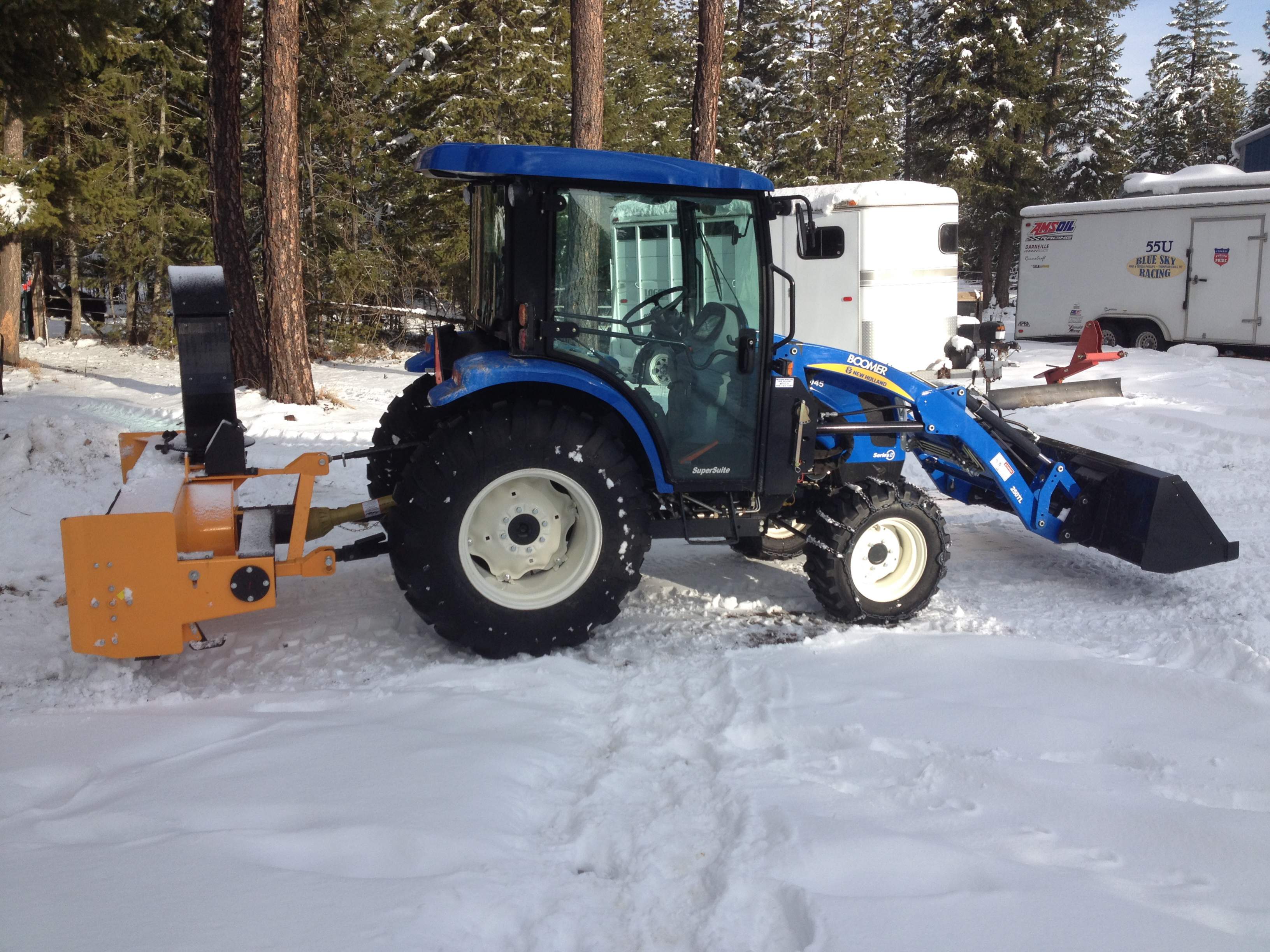

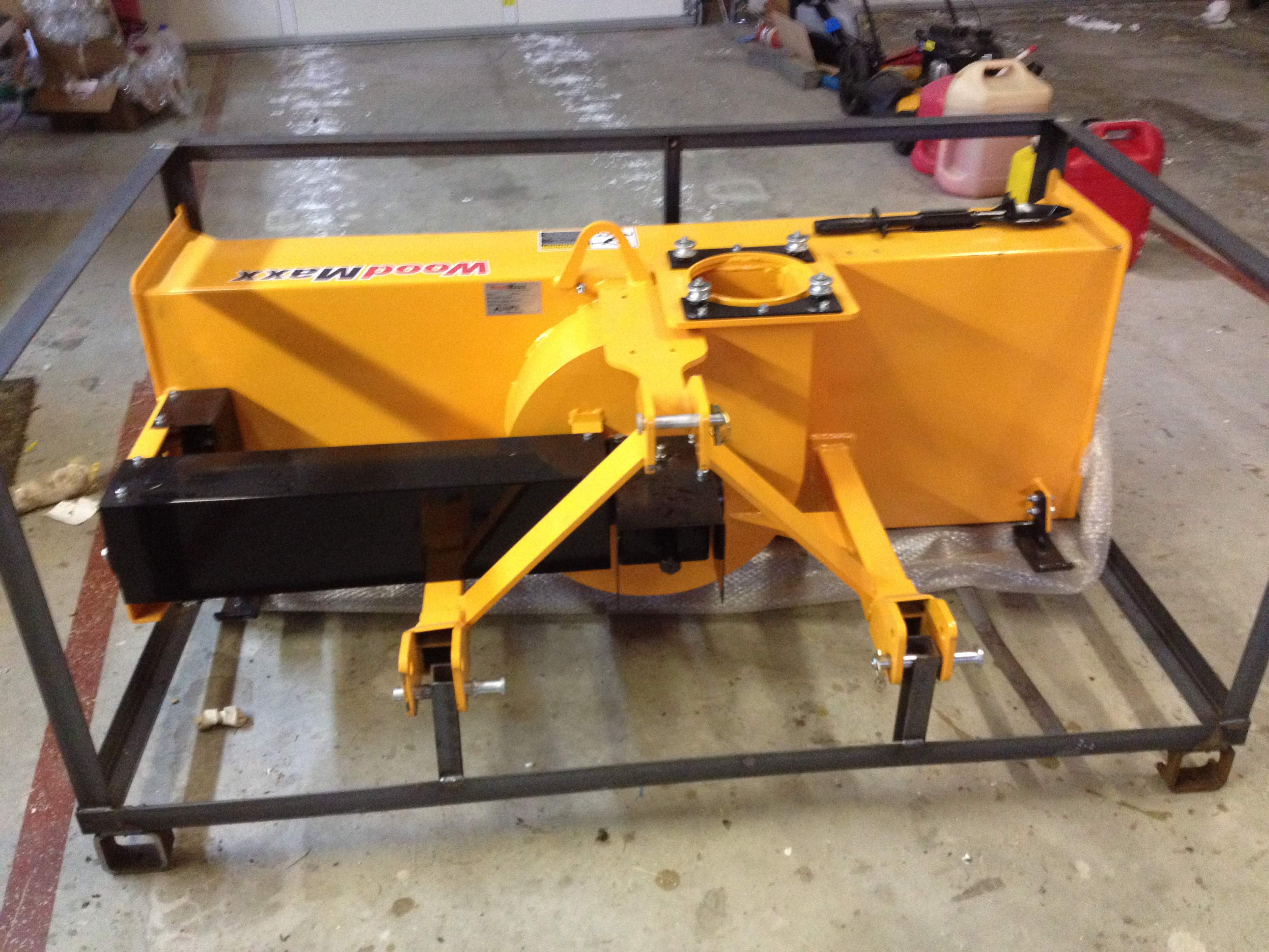

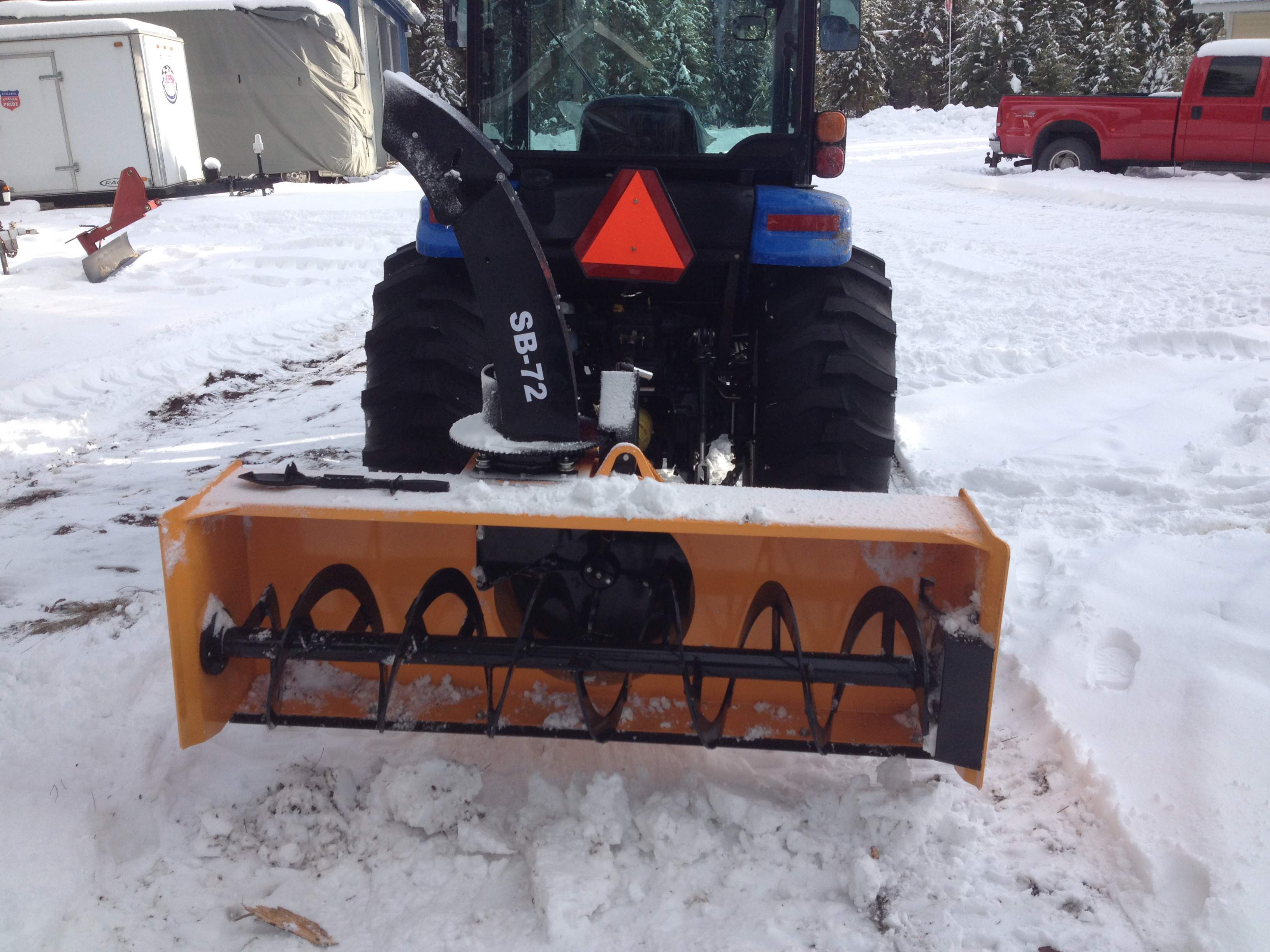

006.jpg010.jpg008.jpg007.jpgWell it got here and I love it.. Blower was packaged in a steel crate and it was a good think cause some of the steel was bent but blower is fine..Used it last weekend in 8 inches of snow and loved it.. Puts the snow well away from the road so no berm build up.. Still trying to get it fine tuned so it wont pull up gravel once in a while.. Gravel in the grass is no big deal but I hate to see it remove paint on the lower side of the drum.. I really try to keep my stuff in good shape.. Should have another 6-8" in the morning.. The wife likes how I have been able to widen the road again with the blower..
   / Snow blowing set up for gravel road #29
Nice, what did that set you back?
   / Snow blowing set up for gravel road #30
It got to you in time. :laughing: I'm sure you are going to like it.
Don't forget to check the auger drive chain tension after a few break-in runs.
