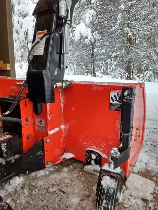

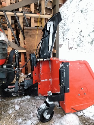

On my second season with my contraption and can't say enough good about the wheel setup. Was not cheap to make but works oh so well, no casters needed just smooth tires from a commercial Toro ZTR mower. Snow lubricates and they simply slide around.
Good luck, Fred
Good luck, Fred
Fred that is awesome. Great job. That is somewhat what I was trying to accomplish
Just not as fancy. I don't typically have a need to adjust the height other than lift it up completely for transport. Awesome job.. I sure wish I could keep my tractor so tidy and clean..

Wheels works great when the ground is not frozen. They are adjustable in 1/2 inch increments, but raised when the ground is frozen, so the snowblower is then on skids. snowblowercastor2.jpgsnowblowercastor1.jpg
