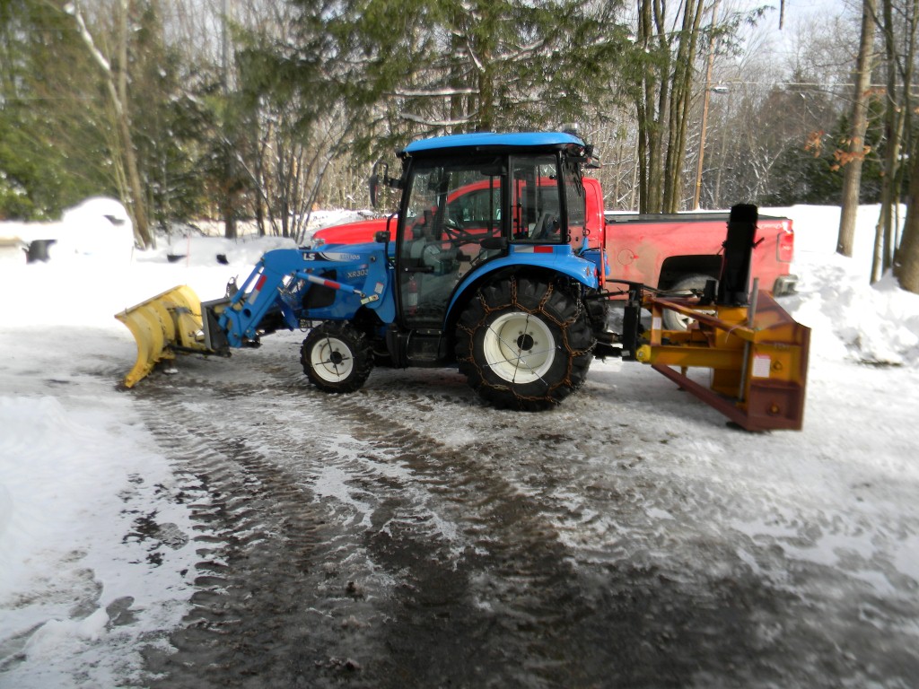

I have both an FEL PA plow and a rear blower and agree the plow is much faster. I keep the blower on for extra rear weight mainly. I plow my own driveway but use the blower on a few neighbors driveways. In my driveway the blower is used to knock down piles later in the season. Blowers are probably popular because you don't have piles to contend with later.
