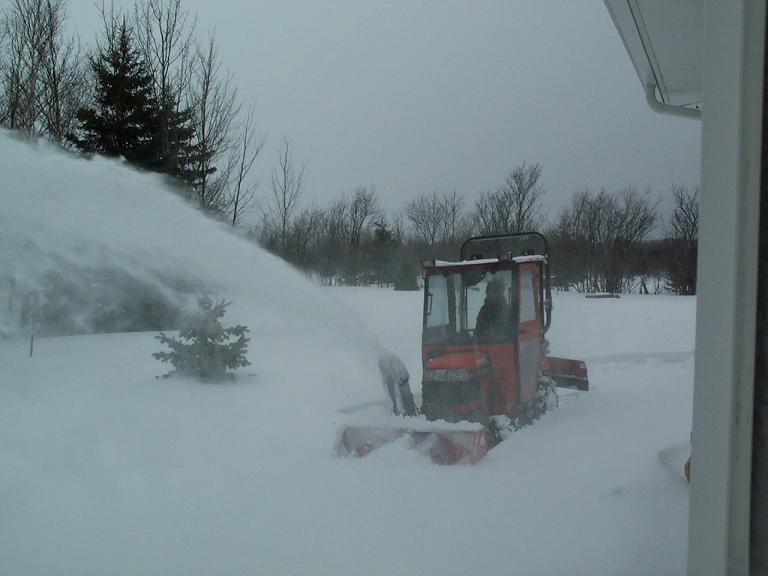

I am looking to purchase either the 60" front blade or the blower for my BX23. I currently have a 23HP Bolens 2WD tractor with a 54" blade. It works well but I spend a lot of time managing snow piles. I live in NJ so snowfall is moderate, averaging 5", but can get up to 14" per storm. I have 8-10 local residential accounts with 10' x 100' drives and 2 car garage aprons. It takes me anywhere from 20-40 min per house. I want to speed this up. Recommendations?
Thanks.
   / snow blower vs blade (front) on BX23 #2
For pure effectivness, I would go with a snow blower, it is going to be much faster than a blade. A blower distributes the snow over a larger area that you have the option to control, therefore reducing management of snow piles. However, one consideration is cost. Is the blower going to pay for itself over time? I believe that it would, because you could perform additional snow removal jobs with each storm in the same period of time that it currently takes you with a blade. The only other downside I see is that the blower could be a problem in tight quarters. To solve that issue I think the addition of a four or five foot rear blade could take care of most tight spots. IMO I believe that the combination of a rear blade and front snow blower may be the ultimate residential snow removal machine. Just my two cents.

If your going to put a cab on, then it's a front blower for sure.
No cab, go with the blade.

First I had this set up:
Rear blower and FEL
It is a 54" Puma, I found it new in Mass in May of 02 for $1000
Then I went with this set up
Front Blower
Got a used, if it had 2 hours on it it was a lot, front blower from my dealer with quick hitch and shaft for $2K, Sims cab was $1600.
If you get a rear blade to get close to garage doors, you will have a great machine.
If you live close to me, PM me and I will show you my set up.

I have both the front blower and the front blade for my B7610. See photo link below. The blade is absolutely unbeatable for snow falls of 1" to 5". It is at least twice as fast as the blower for those amounts. Any more than that and the blower is the best tool for the job. Thanks to the Kub quick hitch, you can switch back and forth in just a couple minutes.
If you can only have one, get the one that matches your typical snow falls where you live.
