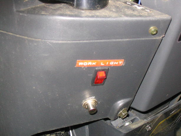

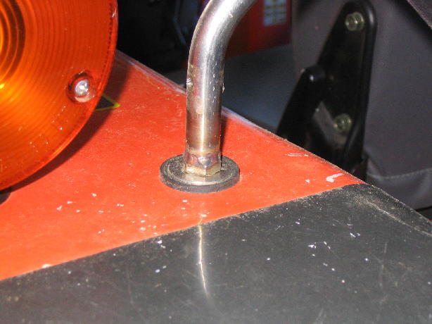

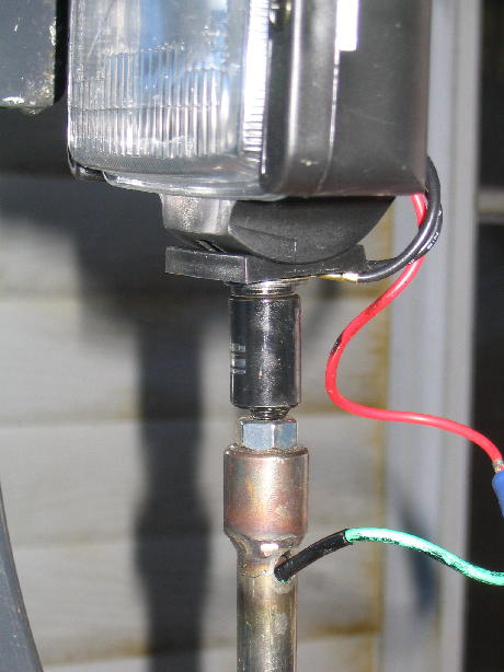

I didn't want to drill any holes in my fenders for lights, so there are some factory holes in them already. So I bent some 1/2 OD stainless pipe into a offset so it would clear the roll bar. Tig welded a 3/8 stainless bolt (about 1 3/4'' long) to one end, oh first you drill a hole thru the bolt so you can snake the wires thru it. Put a flat stainless washer and a rubber washer on the bolt and run the welded bolt thru the pre-drilled holes in the fender. You can tig weld a nut on the other end to accept the light you will put on. Then run your wires to it. If I have a change I'll go out and take some close-up pictures of them and show you them.

here's some pictures of my work lites

another

one more

Thanks for the pictures. Great idea!!
