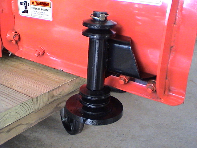

I attached a picture of my skid shoes and the way they are adjusted today. The washers can go either on top or bottom of the support causing the shoe to be raised or lowered plus the washers can go the way they are opposed or lay flat together which would allow some up or down movement if object is struck. I just want to know what is the correct way or the manual way to do this.

Pair all 8 washers like the 2 on top in your picture
Next place one pair on the bottom
Now put the other 3 pairs on the top.
