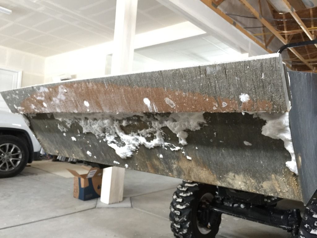

Plowed mine and the neighbors drives yesterday morning, each about 80' long by 45' wide. Floated the bucket the whole time and had to back drag some at the neighbors because I couldn't push snow from garage out, his doors were closed. Trex definitly showing some wear rather quickly:
This'll likely get me through another 2-3 storms but I'll be looking on line for a slab of white delerin or polyethylene plastic that is a little more dense. Overall worked well to get me ready for the current storm, and I could add another piece of trex from the hardware store easy enough but wish it was a little more dense.
