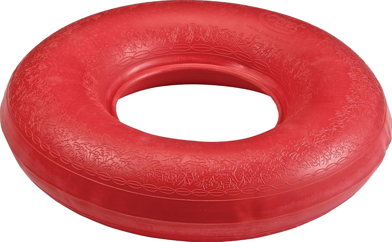

tsavoy, I am being serious here when I suggest this inexpensive, inflatable doughnut. You can cover it with the fabric of your choice, and you can easily adjust the air pressure to your comfort zone. Kind of like a sleep number doughnut. http://ecx.images-amazon.com/images/I/81lu-B9xBEL._SL1500_.jpg Amazon.com: Carex Inflatable Ring Cushion, Rubber: Health & Personal Care

Hahah I like the donut! Yea I need to go check the tire psi , I just sold my ford and the ride was never that bad for me to complain about it.
