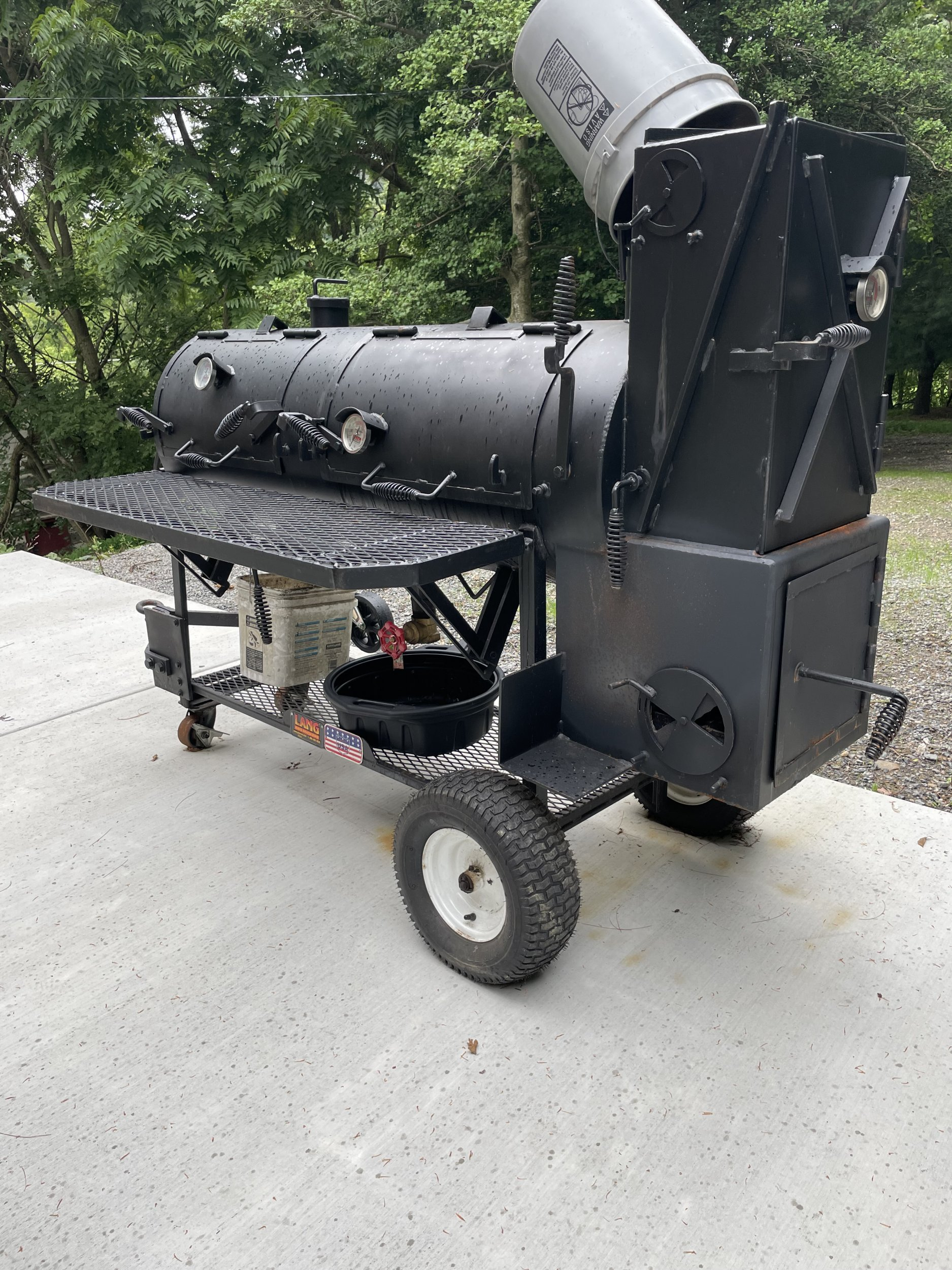

Here is pic of my smoker

This is a really nice smoker!
What is the purpose of the plastic bucket?
Is that a reverse flow smoker, or do you have a damper to direct the smoke?
One thing I've learned is that a big firebox is better so the temperature can be controlled better. I'm never done a cold smoke or fish so I can't help with that.
/ Smoker Recommendations #36
The bucket is just to keep the rain from going into the smoke stack. Yes it is reverse flow. You control the draft via the damper on the firebox and also in the stack there is damper as well to trim it with. And the box above the firebox has its own damper to regulate how much smoke goes up there. That box is good for hanging up fish on hooks and slow smoke it

Last time OP was on TBN was 2018 so it should be ok to hi-jack. I need to replace my off-set wood burner smoker. I've heard the term "reverse flow" but don't know how that works. Can someone bring me up to speed on how reverse flow is designed/work's?
/ Smoker Recommendations #39
Reverse flow is where the smoke is passing through a channel to the front of the smoker and then it turns into the smoke chamber and returns to the front end and up the smoke stack
/ Smoker Recommendations #40
Aahh yes I think I know what you are talking about. Tell me if this is correct. On one that look's similar to yours,smoke and heat leave top of firebox to enter bottom of meat compartment and can't turn upwards because a metal plate force's smoke and heat to go all the way to oppisite end where it turn's up to flow around meat back towards firebox then turn's upwards to flow up smoke stack. Does the restrictor plate have additional insulating features byond that of a steel plate? Does restrictor plate have any holes in it other than where smoke turn's up into meat compartment? Other than a damper for inlet/combustion air and damper in smoke stack,is there normally other dampers? I assume some of the handles on yours raises/lowers grates and other functions which is a personal preferance for each cook. BTW that is a fine looking rig and I'm sure you injoy it.
