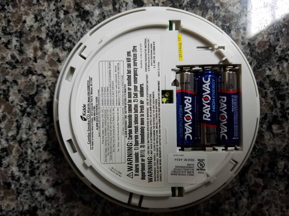

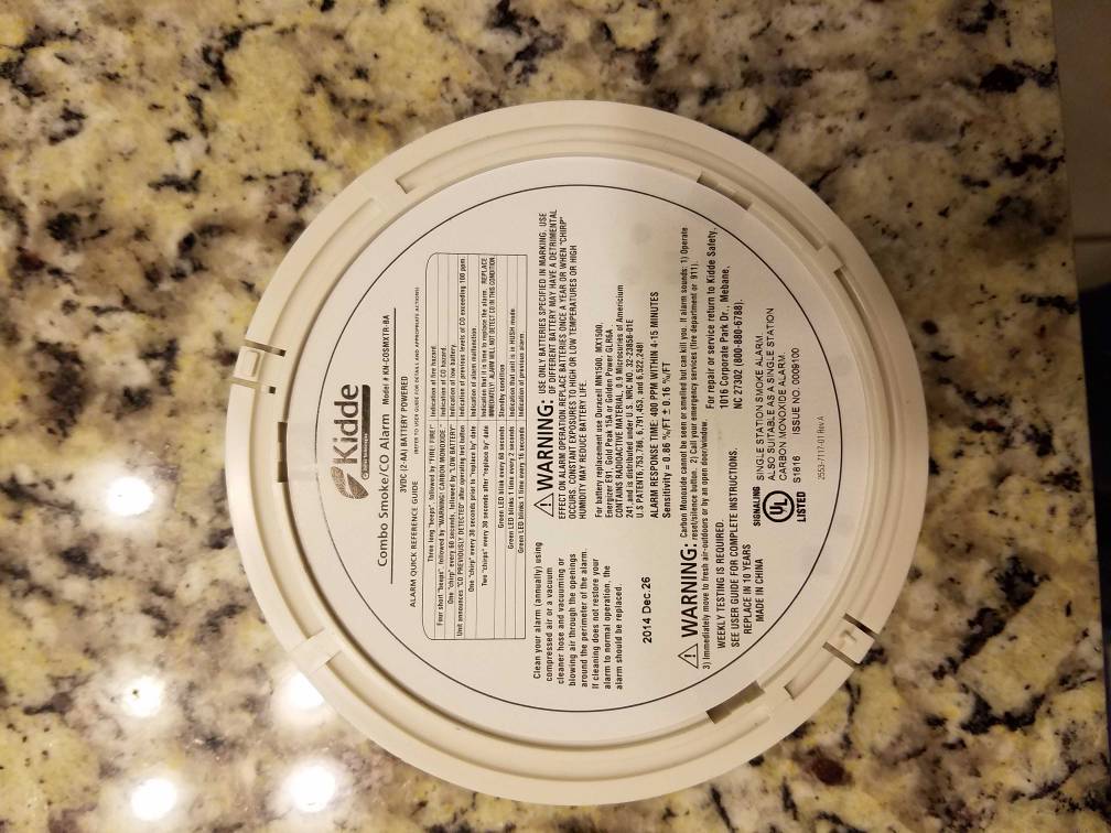

Thanks. Combo smoke/CO or combo photoelectric/ionizing?
These have been less aggravating than previous ones 1539739829259.jpeg1539739895274.jpeg
