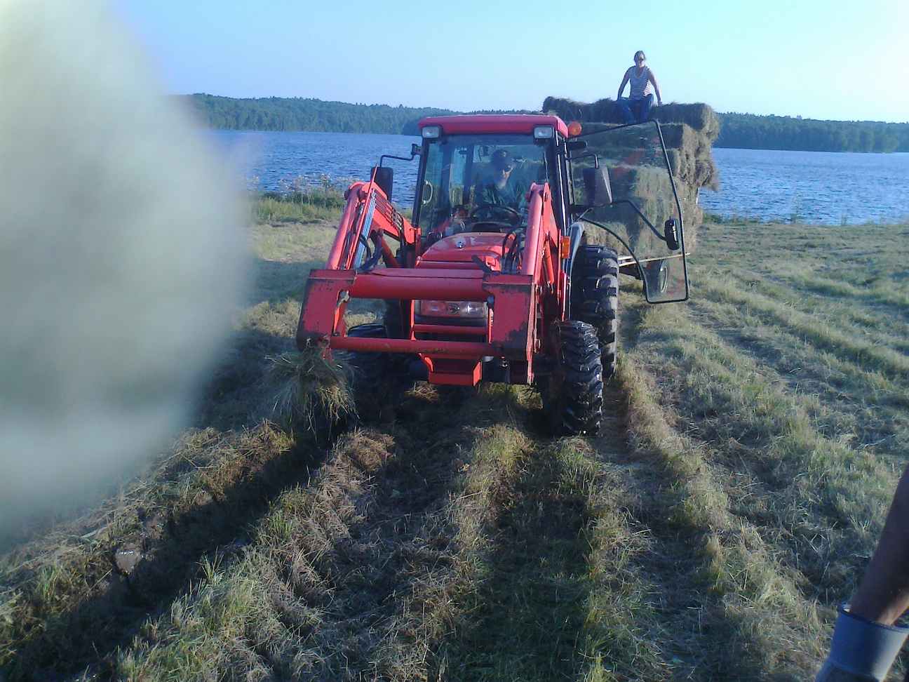

Some of the Kubota's M6800's came in an orchard/municpal sidewalk clearing version. Not a CUT but has a front lockers.
Landini Rex narrow models have front lockers but get up to about 100 hp, not a cut.
I know you don't want it, but in my experience, CUT's don't have large enough front tires for the diff lock to help. My L5030's front end will sink to china before having a problem with spinning. I operate in really wet areas and even just the rear diff lock only get used in the winter. My MF5455 (100 hp) has front and rear lockers and it makes a huge difference as the big tires will get me far enough into wet stuff that wheel spin will break through the surface.
Photo is the L5030 cutting though some wet sod in a field backing up from where it got stuck. Notice the tracks of the 5455 in the grass next to the kubota's tires.

Now that is a pretty picture.:thumbsup:

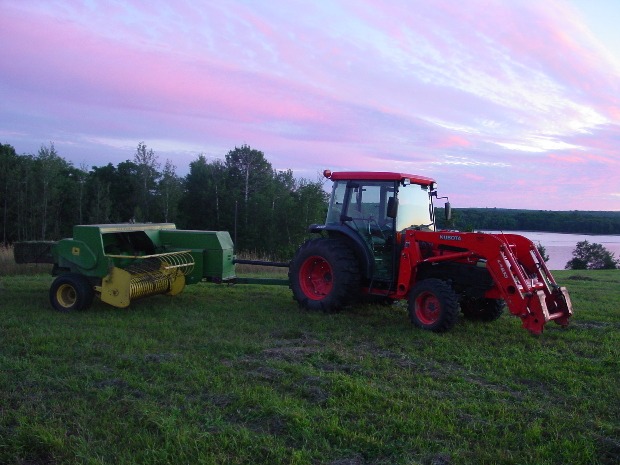

How about this one?
